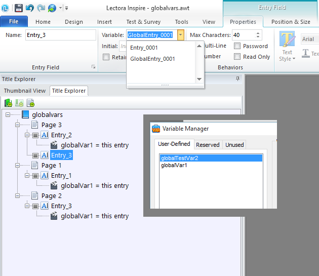

Another 'sneaky' option ( i just tried it ;-) is changing the entry-fields var name in the .awt
So save the awt as is. Open it up as xml in a text-editor, change the vars-names from entry_0001,0002,0003 etc. to globalEntry_0001 and bingo... no complaining of Lectora, opening the awt up again you notice all entryfields do have the same var name.
Adding my quick and dirty test.
I am not sure if this fixes your problems Andrew, if so good...if not..let me know :-)
Kind regards,
Math

Duhh...ok sometimes i overlook the simple things ;-)
When adding a variable...you dont have acces to it in the dropdown. When changing its name in the textfield ..well then indeed like Tim said you can set the other inputfields to the same variable...
Done it before...and now overlooking it ;-)
Yeah missed that ;-)

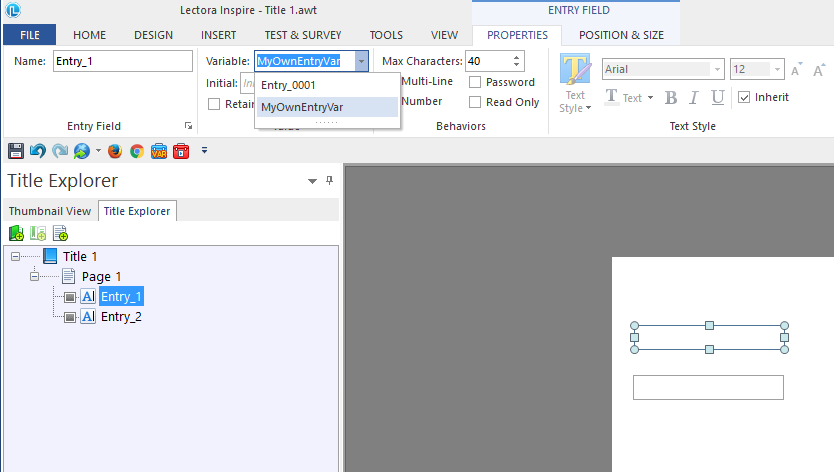

You can only create that variable via the field in the entryfields properties, because it's not a "User-Defined" variable. It's listed under "Reserved".
Tim
Ok Nice Tim... but i guess i miss something basic... cause when i add a custom variable...i dont see it in the properties for the entryfield variables...
You can just assign the same variable to several entry fields by selecting it from the dropdown.
Tim
