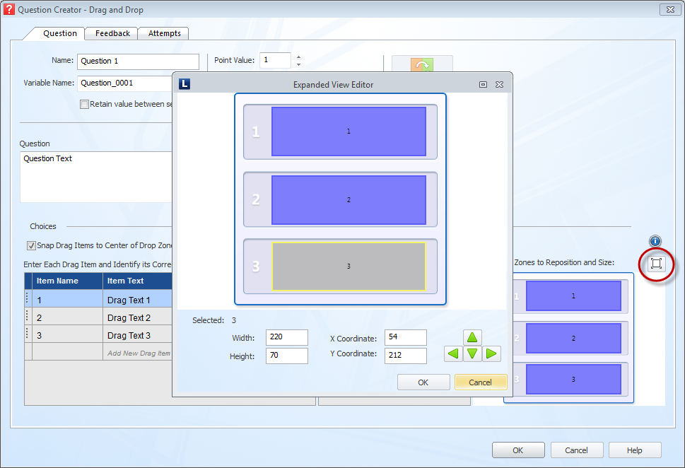

I'm not sure why you are having issues editing your drop zones. Are you using the drop zone Expanded View Editor? That little button on the side of the Question Creator is easy to miss. But you should be able to edit your drop zones this way. (See attached image. The editor button is circled in red.) If this is not what you're having trouble with, please explain further.

PS And yes I did not notice the expanded view editor :(
