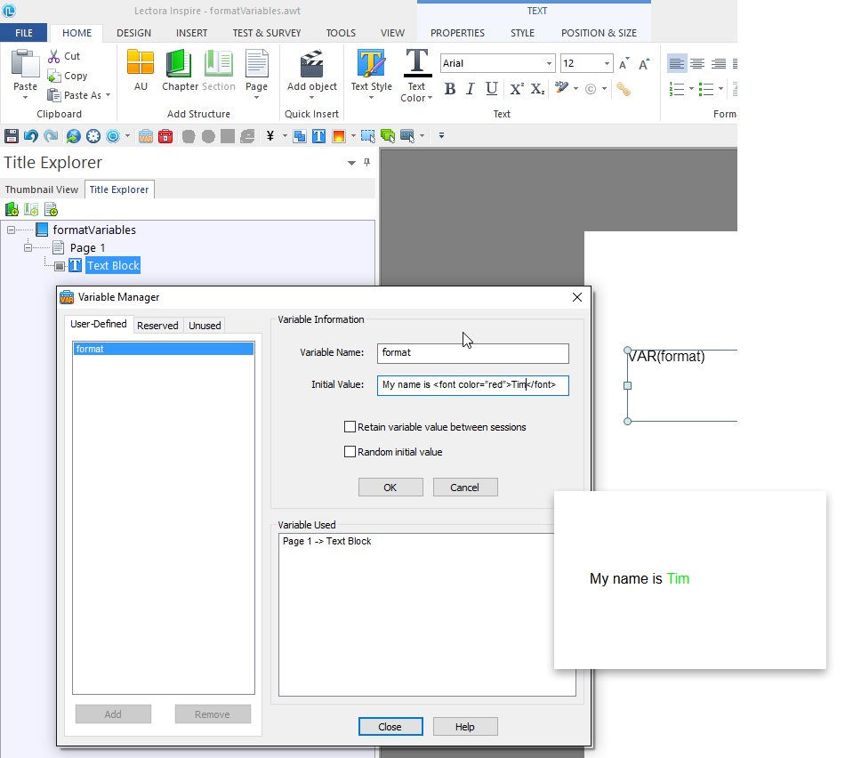

Hi Andrew,
thanks, I didn't know you could format the variable like this.
Interesting is, that if I copy your code directly from this forum (i.e. with the wrong quotes) the text will be green instead of red... Maybe it's a new color scheme ;-)

What I mean is that the html tags are not interpreted, just displayed as is.

It seems to me that it is a similar issue than the one described in the other thread. If I modify the variable (incl. a font style) and change the content of the textfield on click of a button the tags are not interpreted. If I then reload the page the new value of the variable in re-inserted inline and the tags are correctly applied. So the tags are used on page load only, any formatting tags added later are made a normal undefined.
