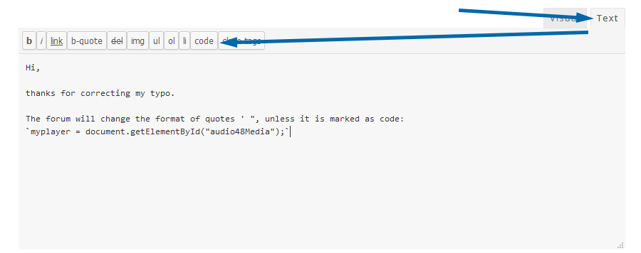

Hi,
thanks for correcting my typo.
The forum will change the format of quotes ' ", unless it is marked as code:
myplayer = document.getElementById("audio48Mediaundefined
Tim
