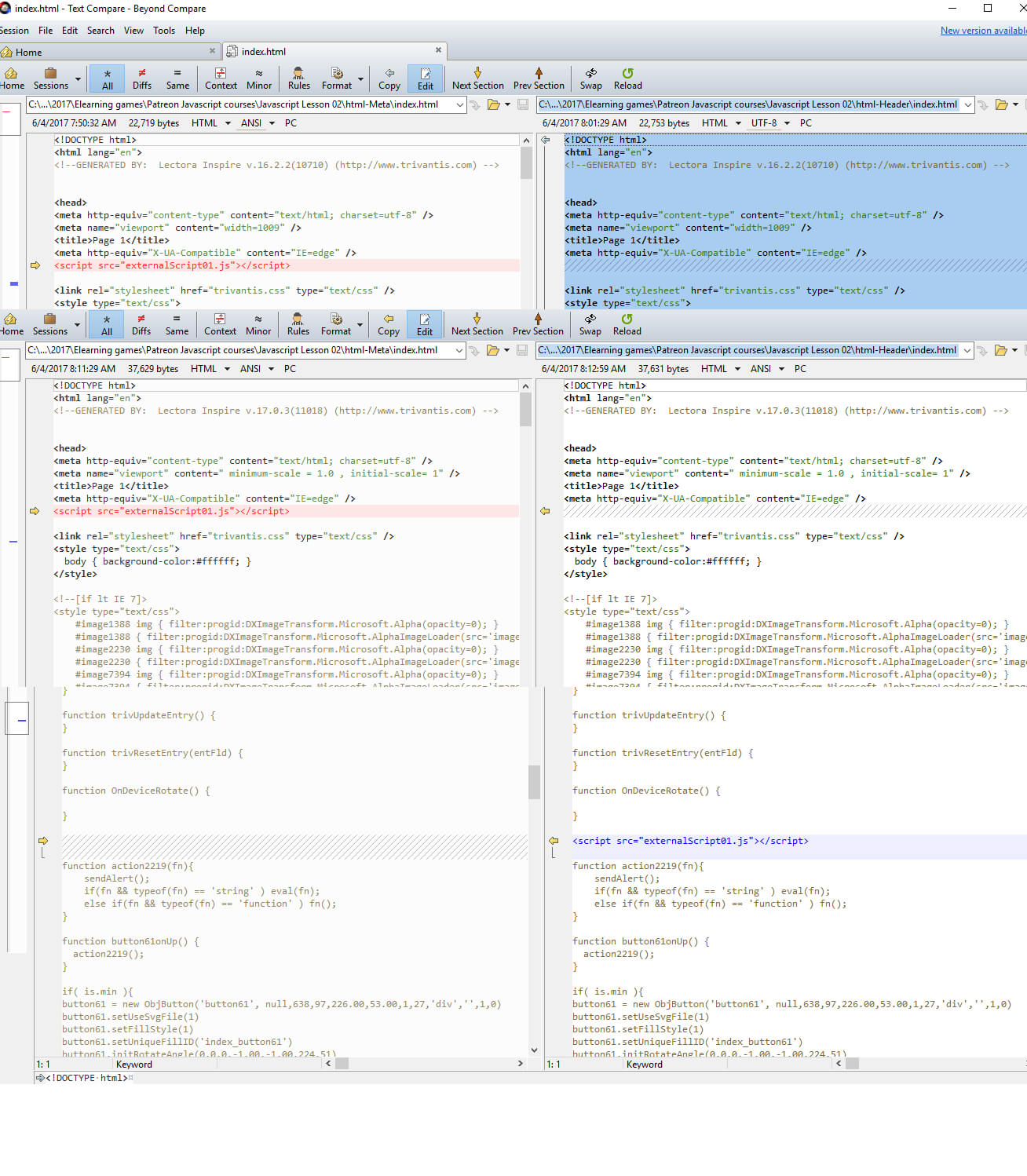

@Klaatu .. hi Darrel.. as i always want to learn new things i tried 'Header Scripting' for a external JS-file. Both in Lectora 16 and 17. I was stumped that with 'Header Scripting' i couldnt get my simple JS-script not working in either version ( not seamless, normal mode ). When checking the index.html published for both versions ( image of a comparison of these added ) i did notice the only difference in the 2 files was the position of the included JS-file. Both were in the header, but the Meta-Tag one was quite on top of the header, while the Header Scripting one was much farther down... and didnot work for me.
Just wondering...anything i did wrong or whatsup here ?

Hey Math, hope all is well by you. Absolutely. That's what I was agreeing with Andrew about; there is no proper way to add a script link just before the closing body tag. We can insert it in there with JS but that's more work. So for now the safest method is to point to your external file with header scripting and let it (cringe) embed your script.
Recognize as well that in both of the pictures above, the JS link is above the style sheets.
Thx Darrel and approg. Still a bit confused yet though why my first and normal approach does work properly and why exact the same setup with the only difference that i use 'header scripting' does not. Probably best to add a sample. Thx again, best and most helpfull people around here on this community and you 2 certainly belong amongst them :-)
~Math
Math, you cannot insert a JavaScript element into the middle of another JavaScript element (which is what your attached image is showing). I use meta tags and header scripting depending on the circumstance.
