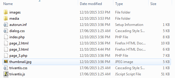

And in fact, when I experimented with it in a new title, it did produce a .php file - and when the php extension was removed, it reverted to creating a .html file although (I think) it did not remove the previously-created php file. Take a look at the attached graphic: page3.php was created by Lectora.
Cool, I never knew Lectora could do that!
