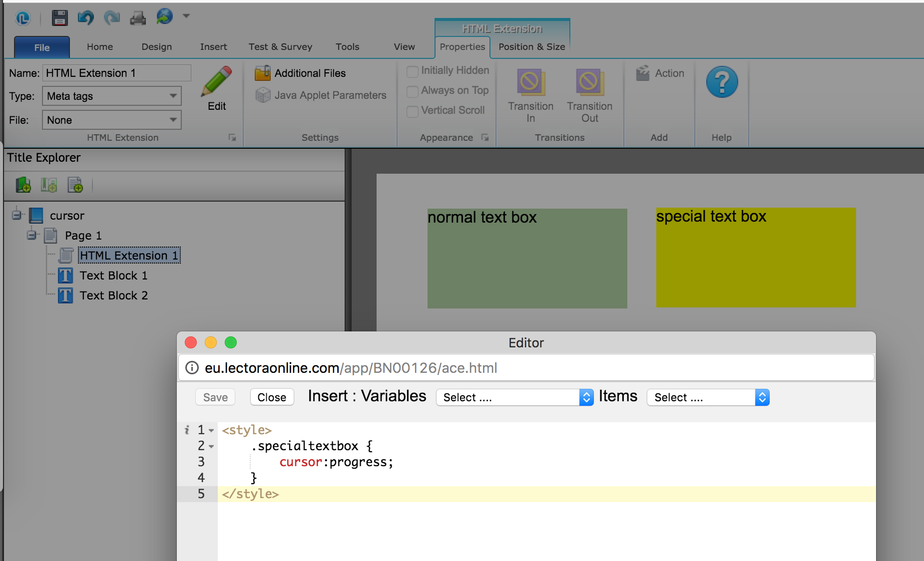

Changing cursor style on entering textbox
As the subject line suggests, I would like to change the cursor style whenever the cursor enters a specific textbox. I do not see a Lectora "onmouseenter" or equivalent nor do I see a way of changing the cursor style in Lectora itself. Am I right or missing something? And if I am right, then how do I fix that problem.
The reason I want to change the cursor style is that I do not want learners to identify links in the text by hovering over them and noticing the shape change. I can change all of the text in the box to active/inactive links and that will fix the problem, but I would like to avoid extra work for the author.
Thanks

Add "specialtextbox" class to a textbox, then add an Ext HTML Object set to META Tags with the following content:
Replace "progress" with any other type of cursor you desire (full list here).
Screenshot and .pkg attached.
