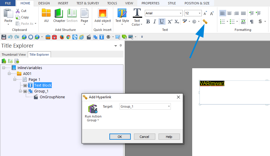

If you have an inline variable in a textfield you can just turn it into a link the normal way. A link can do any action.

Keep in mind that, as Tim mentioned, you can add any action, including a run JavaScript.
I'm not sure if this was part of your initial question but you can use JavaScript to run any Lectora action. Select the action and find its HTML Name like you would any other object (ex. action140). Then in a run JavaScript add:
action140();
Hope this helps.

Hmm, it seems that Lectora odd code strikes again. Although it SEEMS you can add a run JavaScript action using the link on a variable, it will not work. I think there is a work around, however. If you create an action group with the JavaScript you would have liked to run directly by clicking the variable(link) and then instead run the action group it so far seems to work.

Okay. Here is a sample that uses the JavaScript switch statement to display a picture depending on the current value of a variable. You can accomplish this without JavaScript, however, it will take many actions and the more options you want the more actions you need. Using the Switch statement adding additional options is as easy as adding additional cases.
As I mentioned in a post above, while you can add a Run JavaScript action to a link, it will not function. The work-around is to instead add a Run Action Group that has the JavaScript the you want to execute when the variable is clicked.
