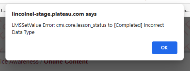

I am getting feedback from our LMS team that they are receiving this error when attempting to upload our SCORM.
LMSSetValue Error:cmi.core.lesson_status to [Competed] Incorrect Data Type.
Online recommends changing status to 'completed' instead of Completed due to it being caps sensitive. I have made those changes and the error persists.
Can anyone assist with addressing this issue? Any help is appreciated.
Thanks
Discussion (1)
The SCORM 1.2 spec is sometimes ambiguous. If your SCO reports a score, the LMS (like Plateau/SuccessFactors) may want a completed status with passed or failed.
So update the Lectora Action that is doing Modify Variable on AICC_Lesson_Status to say passed or failed depending on how the student did. I hope you already figured this out!
