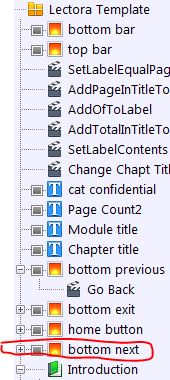

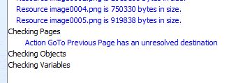

I have experienced a similar issue. I rebuilt the course, 'imported' it into Lectora 12, and had success launching the course in our Saba LMS only after I moved the command for the "unresolved destination" comment I received while publishing - the bottom next was the first image with an action, I moved it to the last of the inherited objects. Once I moved the command to the bottom the issue was gone and it launched fine???
I have yet to get a Lectora 17 course to launch (not too many being submitted, I mainly use 17 for "web tool" creation).

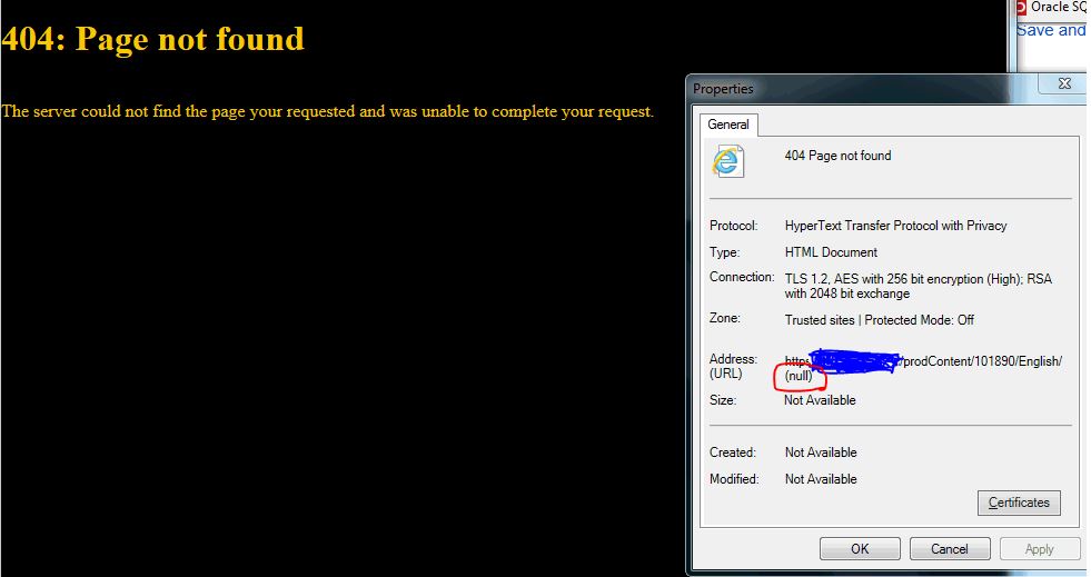

When I get my test courses back from our LMS group I always get a "Some Features..." error like the attached below - this is for Lectora 17 submissions only. We are investigating whether this is Lectora or Saba.
