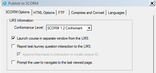

Is your test/survey setting correct?
*That 2nd check box should be selected
