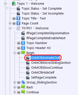

I've just upgraded to L17 and am having some trouble with the Seamless Play publishing options.
I've got some buttons animated with the DynamicsJS Animation Library to give them a nice touch of motion. They work perfectly fine until I enable publish to Seamless Play:
- When previewed in Lectora or browser: works OK
- When published with Seamless Play disabled: works OK
- When published with Seamless Play enabled: doesn't animate
See attached screenshot - when published normally the button animates and the rest of the actions are fired in sequence as normal. When published to Seamless Play however, the debug window show it's firing that first animate action and then getting stuck.
The code on the button looks like this:
