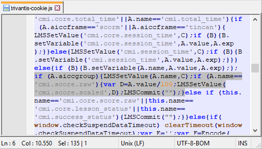

In publishing to Lectora SCORM 2004 (3rd edition) you need to edit the trivantis-cookie.js file in your zipped package (unzip first, edit, and then rezip).
Find the following code in your original file (see image 'trivantis cookie_original file'):
if (A.aiccgroup){LMSSetValue(A.name,C);if (A.name=='cmi.score.raw'){var D=A.value/100;LMSSetValue('cmi.score.scaled',D);LMSCommit("");}

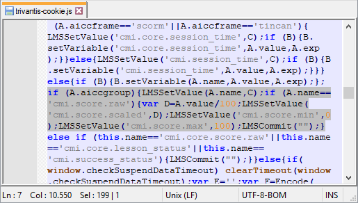

Now modify it to (see image 'trivantis cookie_edited file'):
if (A.aiccgroup){LMSSetValue(A.name,C);if (A.name=='cmi.score.raw'){var D=A.value/100;LMSSetValue('cmi.score.scaled',D);LMSSetValue('cmi.score.min',0);LMSSetValue('cmi.score.max',100);LMSCommit("");}
And that's what worked for me!

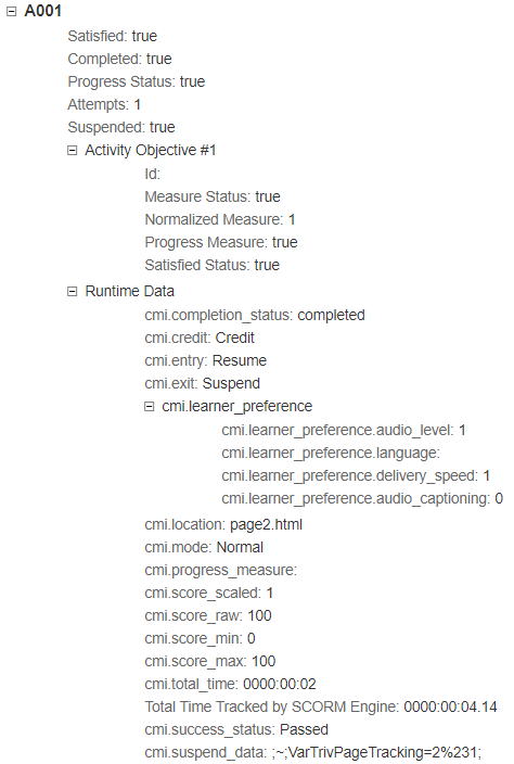

See image 'scorm cloud_registration state'. Here you see cmi.min.score and cmi.max.score filled in just as I wanted them to be.
