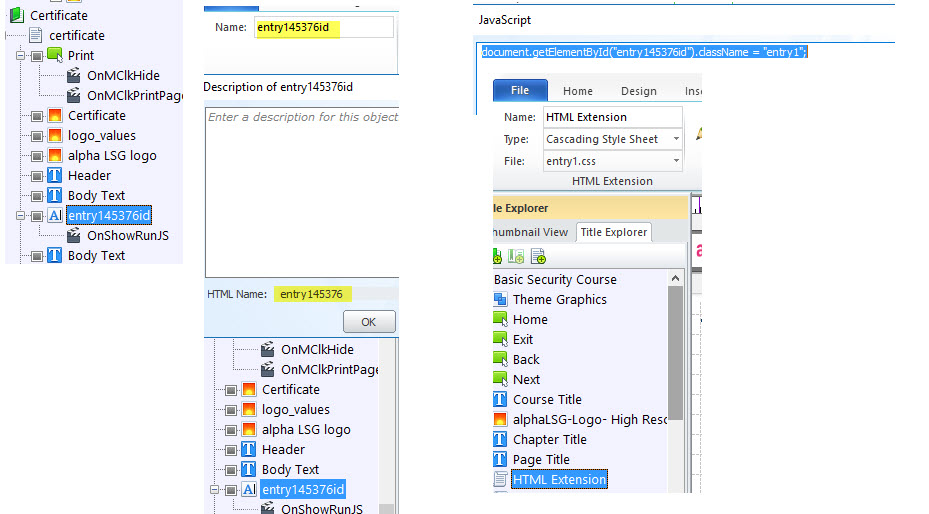

I've checked the settings and all looks well to me. I have attached some screen shots that show the detail.

I re-created your setup from the screenshots and it works fine (see attached). Share your actual title and I'll take a look at what might have gone wrong.

I made some progress as when I compared your file to mine, I realized I had been inserting the wrong Entry ID code, so I now get the correct font and font size, however, I can't get the box to expand, or the static box to center the input box.

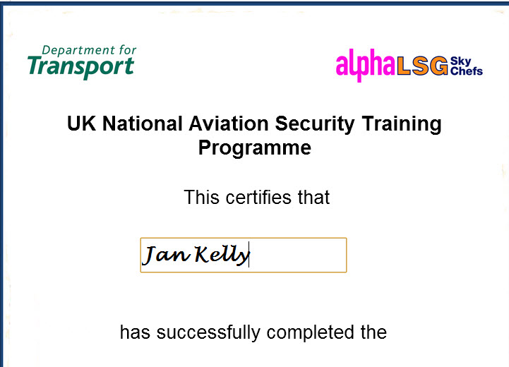

You are a star! Thank you so much, and there was me thinking I had inheritance sorted!! The only outstanding issue is the text isn't centering - see attached screenshot.
Thanks for the time you've spent reviewing this, and more so for explaining the solution to me.

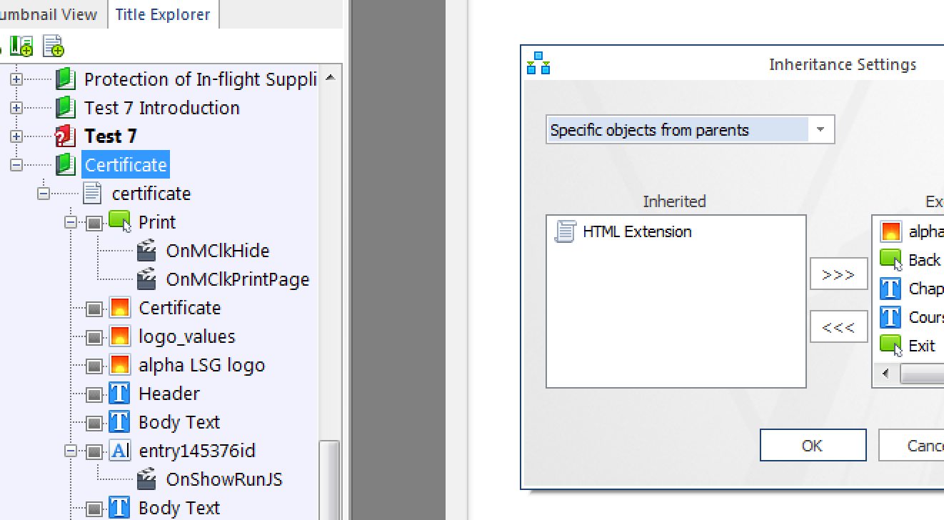

I looked at the project and I found the problem. It is related to how you set up the inheritance. The "Certificate" chapter inherits NO objects from title level, including your CSS style sheet. Furthermore, the "Certificate" page inherits no objects from its parent (from the chapter). So you made sure TWICE that the CSS you created does not get into your certiciate....
Solution:
1. Change Certificate chapter to "Inherit specific objects", move all objects except the CSS file into the right column ("excluded").
2. Also change the Certificate page to include ALL objects from parents.
See screenshot.
Centers on my machine alright (in Chrome).
Thanks, Sergey
I've tried it with Chrome, Edge and IE - all the same! I'll publish it to ReviewLink and see what happens.
