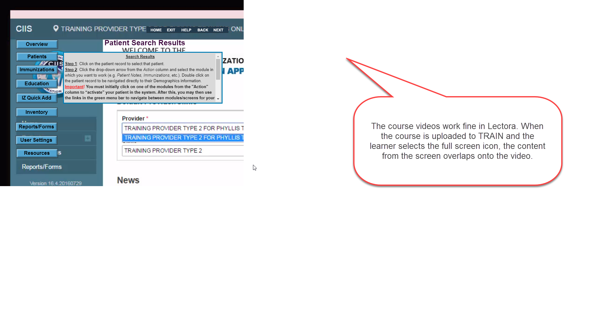

We are using Lectora 17.1.3, and when we publish our courses to the LMS, they don't display correctly in full-screen mode. We are using the Default skin. Is this going be fixed anytime soon? Also, do you have a work-around. Should I go back to a previous version of Lectora?
Any assistance you can provide would be greatly appreciated.
Thank you, Phyllis Bourassa
