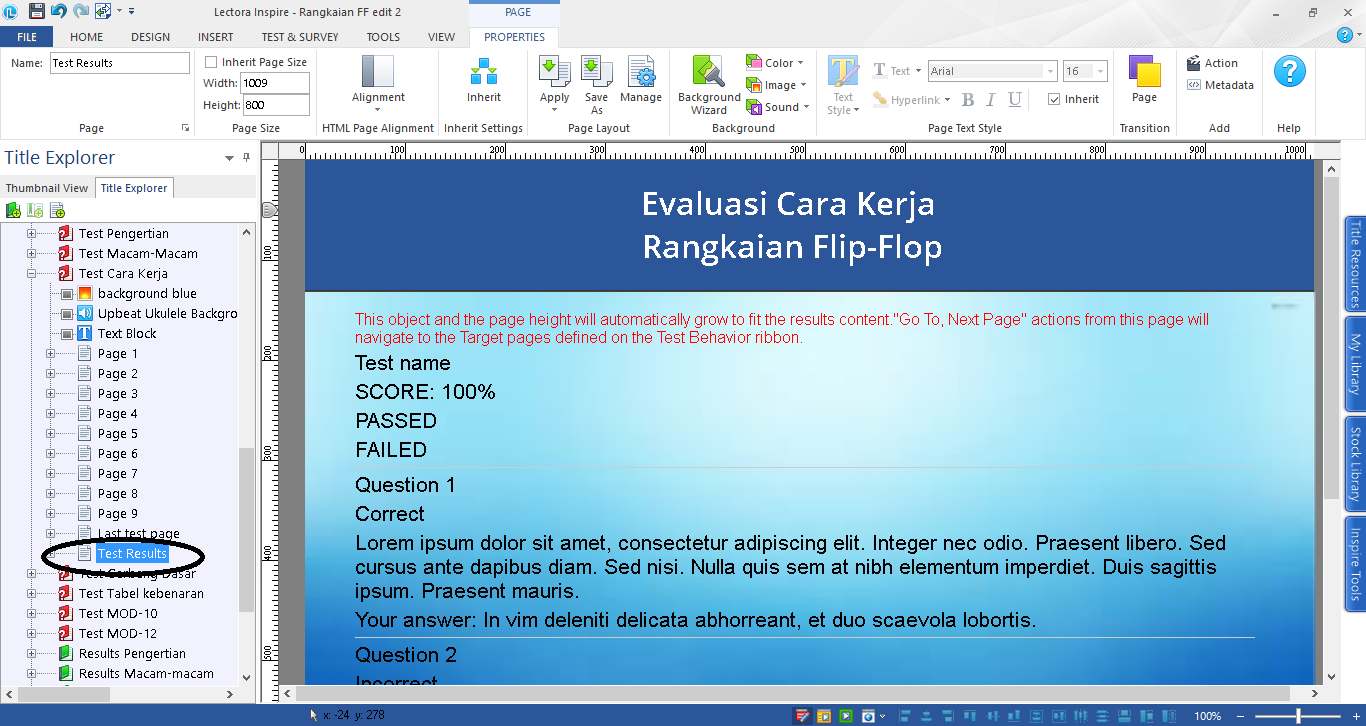

Hello guys,
NB : please understandable for my english. :)

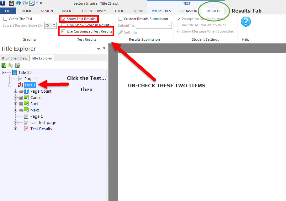

Hi Joe...You are working in a newer version of Lectora than I am but, I don't think that matters (other can correct me if I am wrong).
Go to your test in the title explorer and double click it. Then click on results (tab). Un-check the "show test results" and "Use customized test results" and this will remove the rest result from your test.
I attached an image to help...
Deron
