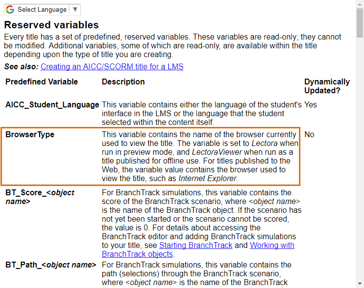

Does anyone know if the VAR(BrowserType) reserved variable can be used to detect a title published for offline use? The Lectora help files (please see image attached), indicate that this variable should be populated with LectoraViewer if a title is published for offline use.
When I published a test with this variable populating a text box, and published as offline output, the textbox is populated with Netscape.

I thought BrowserType should work, because the help file says that it should show LectoraViewer if published for offline use.

The help has not been updated for a while. Lectora doesn't use the Lectora Viewer any more. It's been changed to use Awesomium as the browser to display content published to offline. The good thing about this is that you now can use Javascript in offline content as well and check the url of the course.
