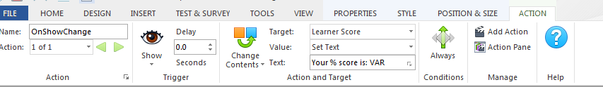

can you share the action you have on that results page to change the number from zero to the value of the ResultVariable?
First thing I noticed is that you have an action at the chapter (Test) level to reset the Test which will fire on every page of the test - is that on purpose?
a bit hard to troubleshoot without being able to see all the actions/interactions, but I can't see any problems with what you are showing - seems pretty straight forward (I replicated a simple version of your scenario - one page adds 25 to a variable, next page changes the context of a text field to 'Your %: VAR(variable name)', and everything works as it should...
