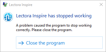

Hi all,
Since upgrading to Lectora Inspire 18, I've been continuing to receive a cryptic error immediately upon launching the application. The error reads as follows: "Lectora Inspire has Stopped Working. A problem caused the program to stop working. Please close the program."
The program immediately crashes after this message displays and you click "OK" or X out of the the pop-up window.
I had reached out to Trivantis Support when I initially began to receive this error about two weeks ago or so. I was somewhat brushed off and asked if I had admin rights (which I do).
A few re-installs eventually put a band-aid on the issue, but now I'm back to this occurring again. I can't develop in the tool at. I've reinstalled, repair installed, and rebooted many times. I'm unable to work in Lectora 18.
Has anyone experienced this issue? If so, were they able to resolve it? I have re-opened a ticket with Trivantis and my organization, but I'm not holding my breath.
Thanks,
Ryan

We have had some reports on Windows 10 where ChartTool.awl would cause a crash. If you rename ChartTool.awl to ChartTool.awl.bak it may solve the crash issue. This file resides in the following (or similar) location:
C:\Program Files (x86)\Trivantis\Lectora Inspire 18

Hi, I've just upgraded from 17 to 18 (I know, late to the party!) and I'm having a problem with the programme not opening properly.
If I open directly from the app shortcut or the file for the app in explorer, it opens and then immediately shuts down. I've tried the suggestion earlier of renaming the file, and it worked briefly (I managed to open the programme once after this) but now it's back to not working again :( I'm on Windows 10 if that makes any difference.

Hello,
It appears that you are encountering a conflict between one of the Lectora files and another Windows file. This conflict is causing Lectora not to launch correctly.
The best solution at this time is to use the following steps:
1) Navigate to the installed folder, similar to C:\Program Files (x86)\Trivantis\Lectora Publisher 18 (or Inspire, whichever you have installed)
2) Rename the file ChartTool.awl to OLDChartToolawl.OLD Note that the name and extension are both changed.
3) Restart Lectora. If there is still an issue, then please delete this file completely and restart Lectora again.
This file is for the tool to create charts, which is not a commonly used feature. If you do have a dependency on this feature, then after successfully launching Lectora, perform a reboot of your machine, then rename the file to the original, and try launching Lectora again.
Please let us know if this does not resolve for you.
We are sorry for the inconvenience!
Trivantis Customer Solutions
