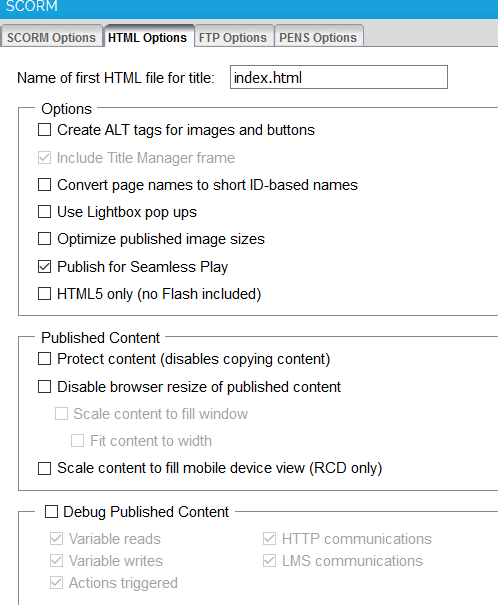

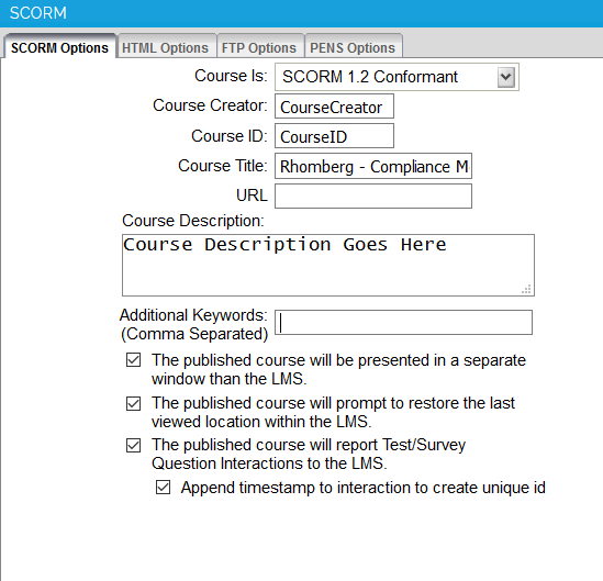

i build a Sorm 1.2 file, Scorm settings in the picture.
Our LMS is Ilias.
i had never before this messages....I dont know what do to... :-(

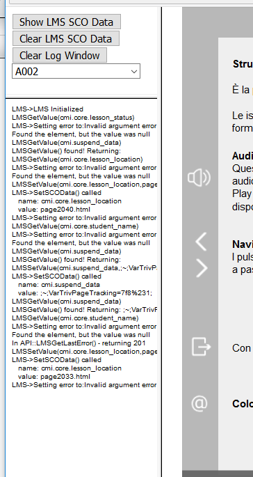

as attachment i have also uploaded screenshots from Scorm-building report.
THX

Is the course hosted in the ILIAS content management system, or somewhere else? If it's somewhere else, you would need different publishing settings. Does ILIAS open courses in a new window, or the same? Again, different settings are needed.
What version of Lectora is that? It does not have the Seamless Play option, which should be in Lectora Publisher starting with V17. Is that Online, which I have never used?
