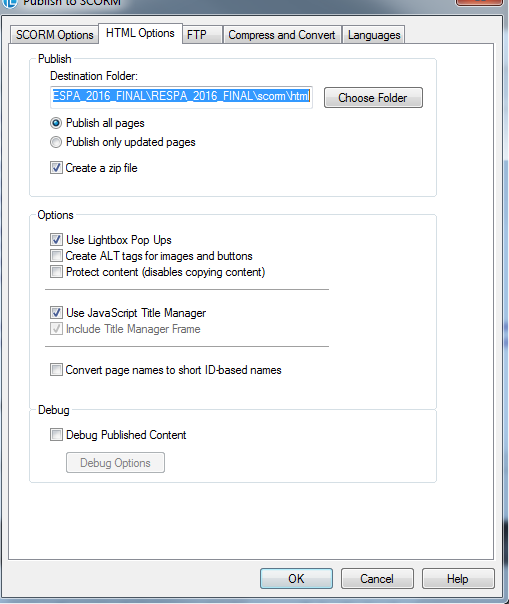

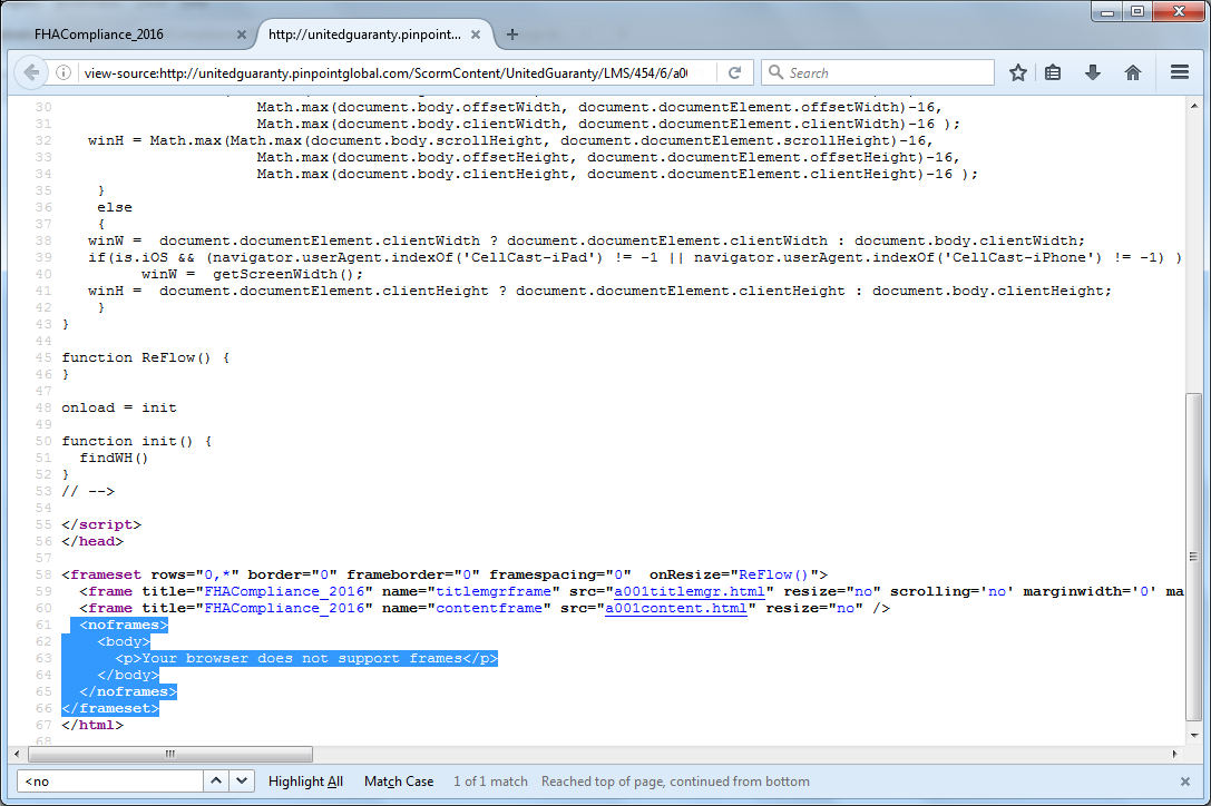

Thank you all for trying to help. Attached are two documents. One that has some code from the browser when it launches. Something is highlighted that we think might be the issue, but not sure and not sure how to fix if it is.
The other file shows the HTML options. Notice how the "Include Title Manager Frame" is checked, but it's greyed out. I cannot change it...does anybody else have this issue.
Any suggestions are welcome and THANK YOU!

The highlighted part of the code is just what the browser is supposed to display if it doesn't support frames, so it's not causing it.
The checked "Use Title Manager frame" is responsible for the course being displayed in a frame. You can see in your screenshot the page contains a undefined with two frames, the "titlemgrframe" and the "contentframe". The pages of the course are loaded into the contentframe. That's why the URL is always .../a001index.html.
The screenshots look like you're using Firefox which is definitely capable of handling frames correctly...
