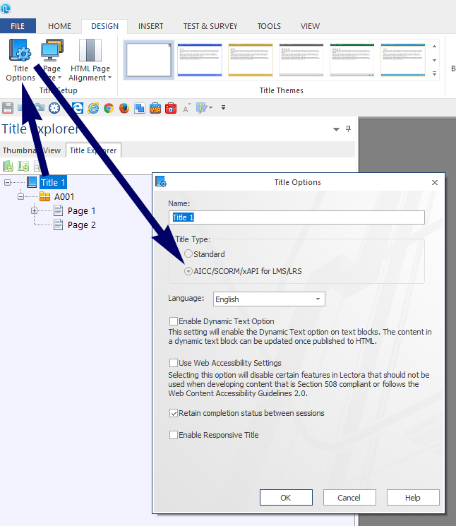

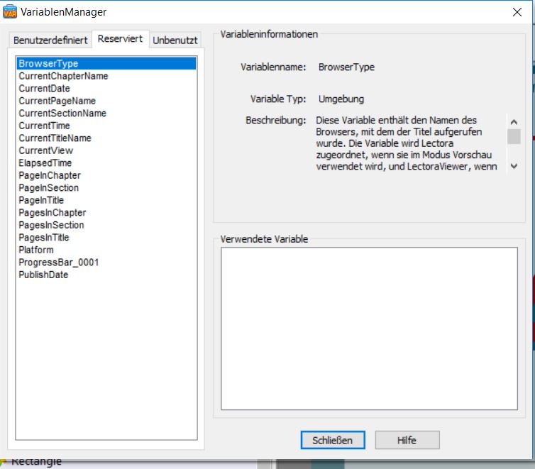

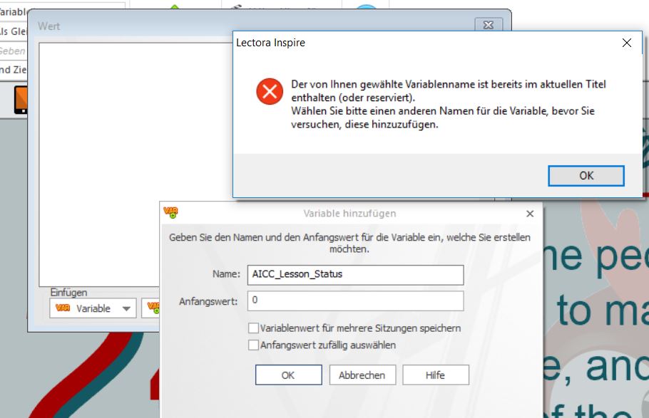

Hi all,
where can i find the presets in lectora 17.
for scorm building i need the AICC_Lesson_Status variable. i cant find this variable.
Discussion (20)
You're title needs to be of the type "AICC/SCORM/xAPI for LMS/LRS" that can be set in the title options.

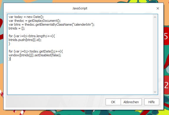

so what i have to do, when i want that it begins with the 1st Dez. Is there something that i have to change in the javaScript editor or does it recognize when the month changes.
i like this :-)
hi Tim, can you describe me please how this works?
nice greetings, marcel
var today = new Date(); // this instantiates the Date object
var thedoc = getDisplayDocument(); // creates a variable out of the getDisplayDocument so you can use thedoc in its place.
var btns = thedoc.getElementsByClassName("calenderbtn"); // Create an HTML collection (not an array) out of all the elements that were assigned the class calendarbtn. Keep in mind that the order, which is important here, is the order in which the elements appear in the DOM top down. The order in the explorer pane is the same as the order in the DOM. I'll explain more at the bottom just know for now that if you have the buttons in order in the explorer this will work.
btnids = []; // Declare a new empty array to be used below.
for (var i=0;iundefined // this adds each buttons HTML id to the end of the btnid array on each iteration of the loop.
// At this point btnid is now an array of all the buttons HTML id's in the order they appear in the explorer panel.
for (var j=0;jundefinedj++){ // this creates a loop starting with 0 and continues until todays date
window[btnids[j]].setDisabled(false); // This will enable a button by setting its disabled property to false if its position in the array equals the iteration number which will be less than or equal to todays date.
Nice job, Tim. Hope I explained it correctly / sufficiently.
Unless you did it for clarity, I would not use a variable (thedoc) in place of the getDisplayDocument method in this case because you're only using it once; you actually typed more than necessary.
When I was talking about the order above, if you were to move the 24th button just under the 2nd button in the explorer pane you'll notice that the 24th becomes enables on December 3rd (its new position).

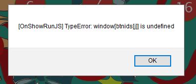

Hi together, i need your help, i want to start my advents calendar again. I took my template from last year but now there appears an Error message. Can you help me please? greetings marcel
That happens because today is the 27th.
Replace the second for loop with:
for (var j=0;j<24;j++){if(jundefined

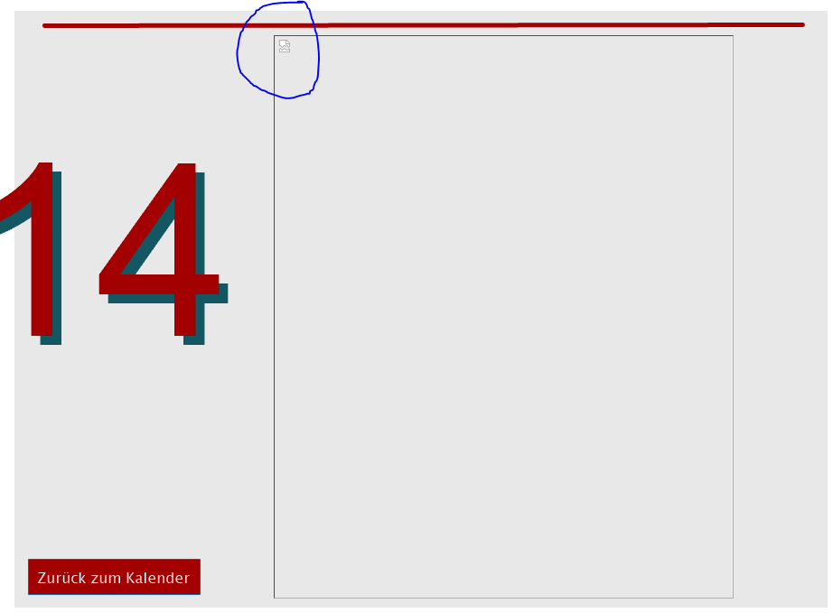

I can't recreate the error. That symbol means that the image file cannot be found, e.g. when the url of the image in the src attribute is not correct. You could try to rename the files, it may be better not to use caps and umlauts, e.g. "tuer01.jpg" instead of "Tür01.JPG", but I'm not sure it'll help.
it works great but do you know what could be the reason that all my pictures are not displayed, The picture are screenshots (png) from Internet and i have imported them and not linked. There is only a small symbol in the left corner? You can see it in my screenshot...
greetings
Hi Tim, thx, now it works finally :-) i have renamed all the pictures.
