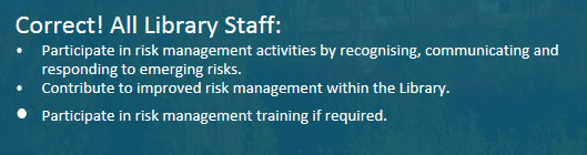

I am venting about bullets in Lectora!!! Coming from Articulate, I want to pull my hair out! (Don't get me wrong, there are great things about Lectora that you cant do in Articulate - but Articulate always looked clean and neat as a published course).
My bullet points have to appear as the instructor talks about them in the video for each page. Therefore, I have to paste in each bullet point one-by-one and line them up perfectly vertical and horizontally. It is quite time consuming, but I don't mind - that part.
I even copy and paste into notepad and then paste unformatted text for each bullet point as suggested. And then I format each bullet point seperately as Arial text, size 16 font. Again, time conusming and should be an unnecessary step - but I can deal with it.
What I do mind is that when I preview my course, it looks fine, but when I PUBLISH my course (to HTML or SCORM) the bullets appear big and small, sometimes there is a space in the first line - so that it doesn't line up with the text in the second line, or there is a space on the second line so the line above doesn't line up.
Again, this would be fine if I could go back into my course and fix, but everything looks fine on the edit screen. There is nothing I can do but copy and paste into notepad AGAIN and then paste unformatted text into Lectora AGAIN! It is making me nauseous just thinking about it. And yet I have to do it for 117+ bullets for this one particular course - AGAIN.

We have Lectora 2016 and this is STILL an issue!!! It's SO FRUSTRATING!
EVERY time I copy and paste text from elsewhere (word, powerpoint, notepad even) the final bullet point is ALWAYS larger than the rest!! What the hell people!? I've wasted SO much time trying so many variations to the point where i just delete it and type it manually!!
FIX IT, PLEEEEEAASSEEE!!!!!!!!!
Wonky non web standard coding/programming is at fault. I find this work around helps. Add an extra bullet, preview in browser, close preview, delete extra bullet. Preview again and the bullets should all be the same size.

Later, I found the solution for this issue by doing few steps:
  1. select the text box
  2. Reduce the font size by 1 pt.
  3. then go to edit or double click the text box
  4. Now select the texts and increase the font size.
It is working fine for me.
