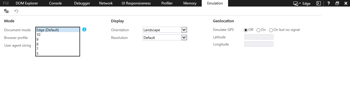

We're aware of an issue in Lectora 12 where images don't display when IE11 is being run in compatibility mode - essentially acting as if it were in IE8 or earlier. You can test if this is happening to you by opening IE and selecting F12 to open the developer tools. Then select the Emulation tab and check the Document mode.
We've got a fix for this issue coming out in our next update, due out shortly. We'll send an email when the update goes out, and you can review the release notes (once posted) here at that time: http://trivantis.com/service-pack-downloads/
