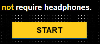

Text Button Font is blurry
Hi, I created a text button. Custom yellow background. Black text, Arial size 20. In preview mode it looks fine, but when i preview it in a browser or i publish it, it's blurry.
The text boxes are fine, it just seems to be the buttons themselves.
Any ideas? Thanks!

Hi all, we think we found the issue. It was because there was shadowing on the text buttons. Once we removed the shadowing, the buttons were much crisper!
I see the issue in all common browsers with or without a shadow. When viewed at 100% zoom level in the browsers it seems pretty crisp. As soon as I zoom in or out it gets blurry. I've tried Arial and Lucida Sans Unicode font on the buttons.
Buttons seem to be rendered as graphics (not as HTML buttons) and since the text is a bitmap graphic, zooming it will screw up the appearance.
Build your own buttons. They will be much nicer looking and you'll have complete control over every aspect of styling (including transitions and transformations if you'd like) and zero weight.

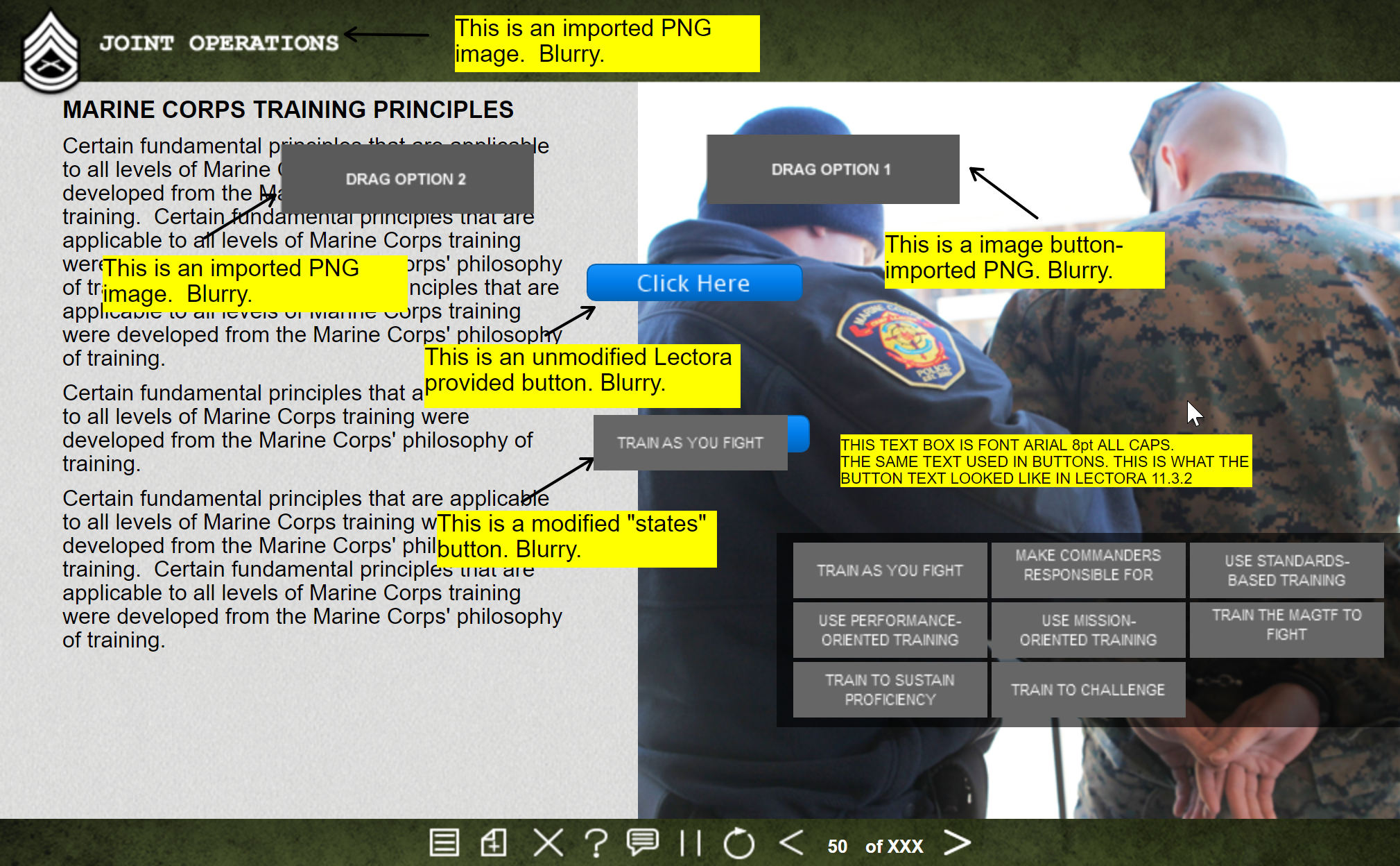

I'm having this same issue. I was previously working in Lectora 11.3.2 and recently upgraded to Lectora 17. I opened a project built in Lectora 11 and noticed the text in all of my buttons was very blurry on preview and publish and in the LMS. It's not only the buttons, all the images are also fuzzy. This same project looks great in Lectora 11. I contacted Lectora Support in December and they have not been helpful and now completely unresponsive. Has anyone found a fix to this issue? This is causing a real problem to my project.

Commenting to share my frustration that Trivantis hasn't addressed this. The solution shouldn't be "make your own custom images" or "create your own CSS". The Lectora 18 version I'm currently using bloats a published course with dozens of text blurry PNG buttons, (not to mention the duplication of every button instance of the same (or identical) source item).
If most of these can be fixed with CSS why is Trivantis generating PNGs in the first place, I can't really see a need for a feature that takes a non-image based item and needlessly renders an image for it. Displaying items that can be generated (like buttons) without images is pretty much the go-to for web for more than a decade. Can you imaging if this Trivantis Community Forum was built with Lectora18? ...each list text item under your name would be 4 separate image states/images of blurry selections (Activity, Profile Notifications etc.).

The blurry text issue was fixed in v19 we are sorry this had been an issue for so long.
The multiple image files is remnants of supporting IE 8 which we supported up until late last year. We will work on getting removing the code that generates all those extra files.
