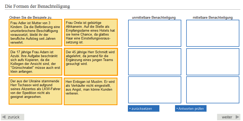

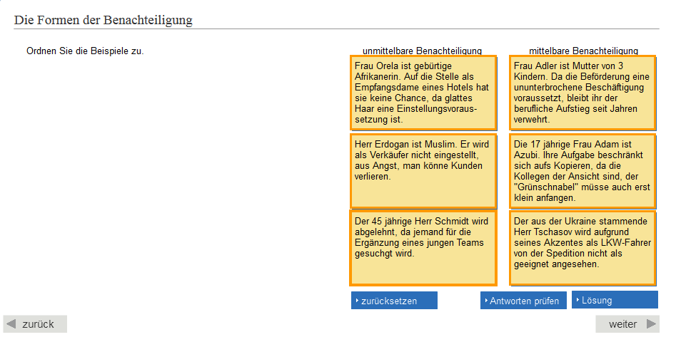

Is there an easy way to show the correct solution in a drag & drop question? (see screenshot dd = question and solution = solution)
So far I found no way to move the drag-objects to the correct drop-target by hitting show-solution-button. I obviously can not manipulate question objects, and drag-objects are part of the question. Even using the feedback worflow, the move action can not udes to manipulate the drag-objects.
I see only the possibility to duplicate the drag-objects manually and the show the correct solution by an action (and hide the original drag-object with a white box...).
