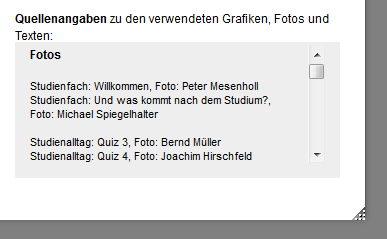

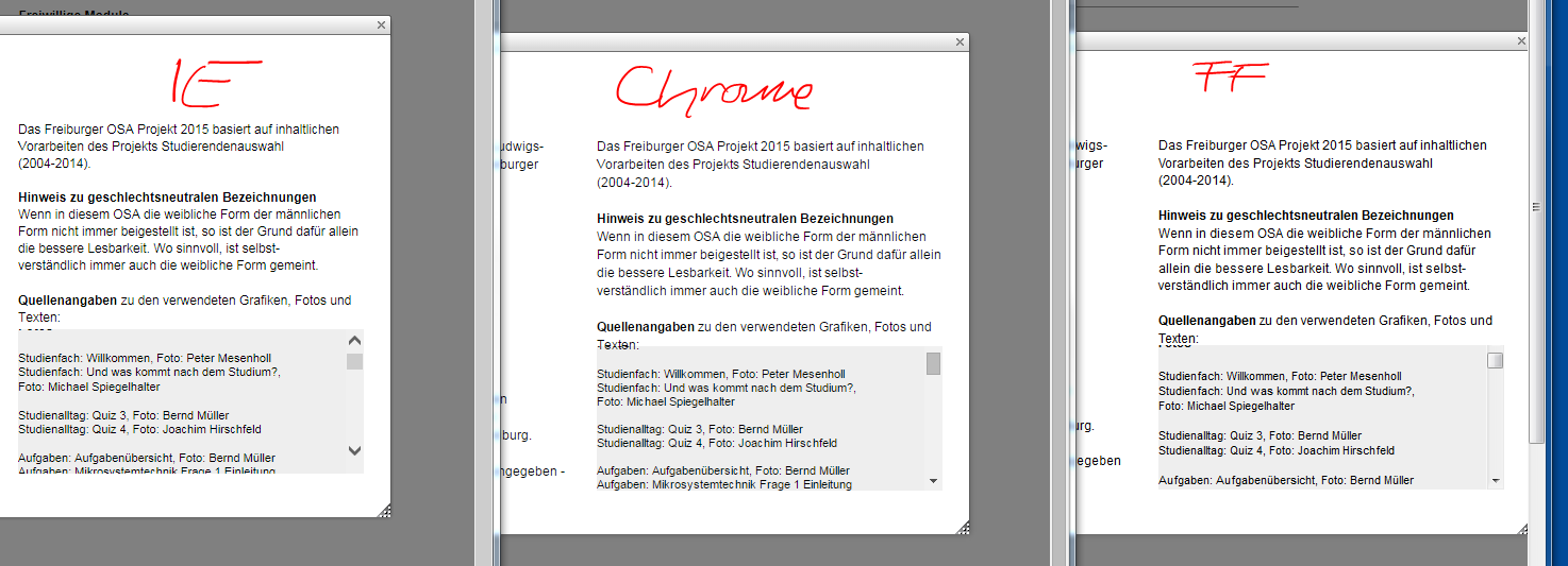

When using vertical scrollbars on a page opened as lightbox pop-up, to top margins not working correct in Firefox and Chrome (IE seems to be correct). The first line of text and the top arrow of the scrollbar is not visible (see screenshot).
I don't know what might be wrong, so we have a bug here?

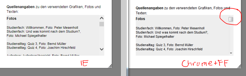

The first line in the text box is empty, so my users ca see the text. If text is starting in the first line, the problem is visible (see new screenshot) - and it exists in IE too.

I tried to fix this by changing the margin size. But then the scroll bar position is changed in a bad way (see screen shot).
A workaround may be adding a style with some padding...

@rfuest6134, The issue is that your Text Impressum re textblock in the popup page is covering up the very top of the scrolling text block. Adjust the position of these two text blocks to no longer be overlapping and that should resolve the issue.
