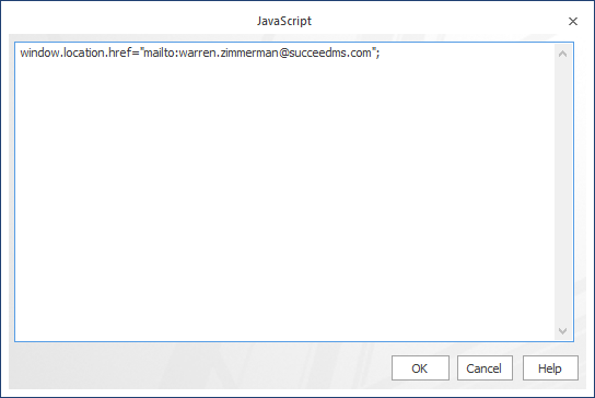

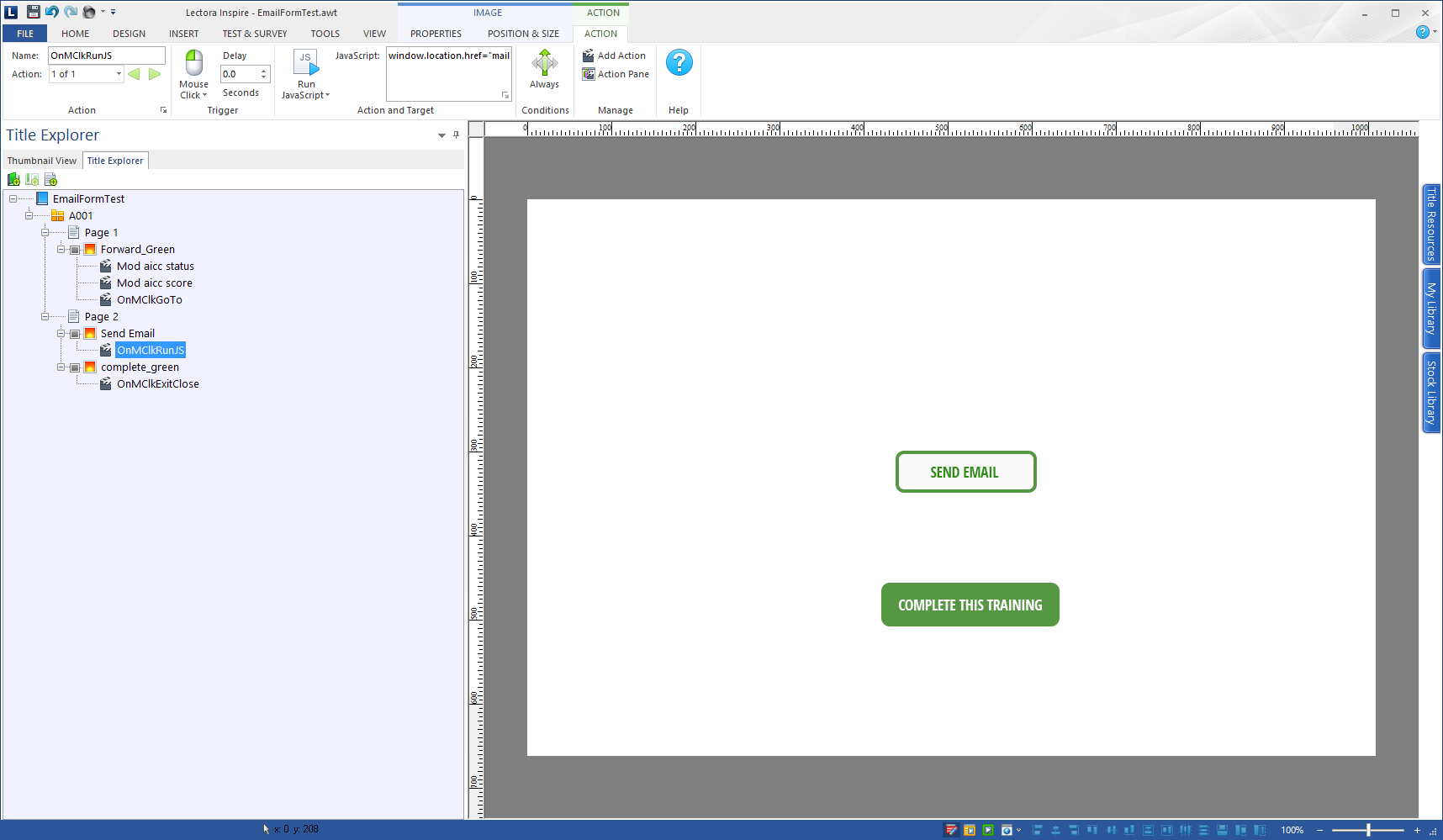

Your post was very exciting when I first saw it, but now that I'm attempting to implement it, it's not working at all.
I've even scaled back to just the most basic javascript not using any variables at all, and it won't open a simple mailto: link. I'm using lectora 11. Screenshots of my setup are attached.
This script:
window.location.href="mailto:myemail@mycompany.com";
Added to a button as a "Run Javascript" action on the button, but nothing is happening. I must be missing a checkbox somewhere? This should be very trivial. I'm testing as a tincan export in scorm cloud and the course is passing and completing, but the javascript refuses to work?
