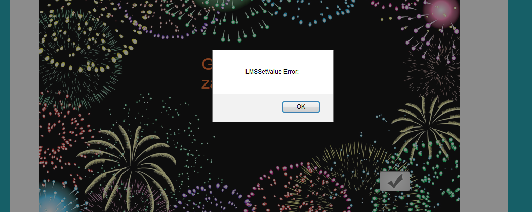

Dear Lectora Inspire users
I also have LMS SetValue Error in my course but it is unspecified
My course in LI is inserted in my university ELearning platform based on Moodle
This error message shows when I'm clicking on Process Test Results button. All answers from the test section are properly transferred into ELearning platform but I want to get rid of this Error message.
Is there any mistake in test section parameters?
Seems like either something is missing or the course tries to fill in a variable that doesn't exist. But that's very difficult to troubleshoot with so little information.
What are your parameters?
Are there any error messages in the console?
Which Lectora version do you use?
Can you share the AWT?
1. What do you mean by parameters?
2. After Lectora Inspire internal control of a project (by a command "publish") there are no mistakes that enable me to create a course for Moodle-based platform
3. I'm using 18.2.1 version. Maybe updating a program to 18.2.2 will solve a problem
But does it help to share a single AVT file?
You wrote about the "test section parameters". Your publishing settings may also be relevant.
When you open the course in moodle, and take a look at the browsers developers tools (F12) when you click the button it may show error messages that allow to gather some more information about the error.
If you shared the AWT file along with the related folders "images", "media" etc. I (or someone else) could take a look at the project and maybe find the error.
