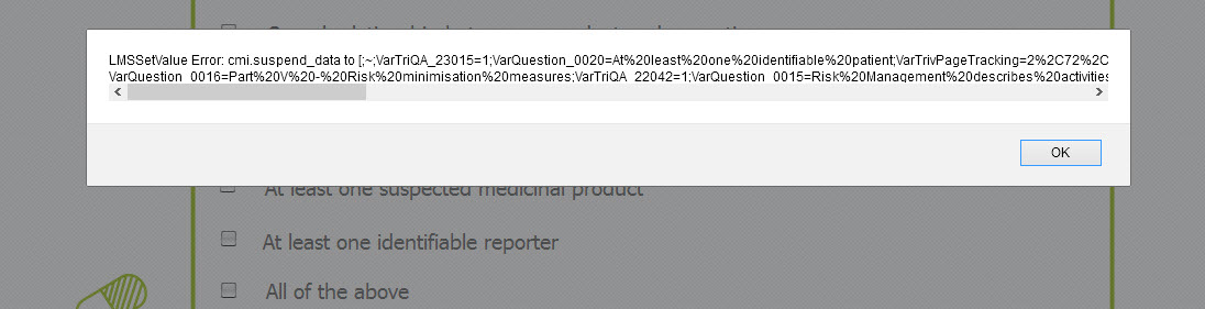

I've been playing with the test I created for our course since Monday. Actually...I've been playing with trying to publish it to our LMS. Unfortunately, our LMS is Ilias or shall we call it thecompletetorture LMS.
All modules up to now I've published as SCORM 1.2...and everything worked just fine, so I tried to do the same with the test...but...it showed some weird mistakes which are in the attachment.

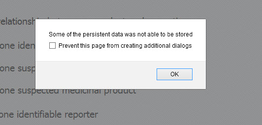

i tried to publish it again (with this modified test option) and hurray!! I got through the whole test without the error message until the very end (it is in the attachment as well).

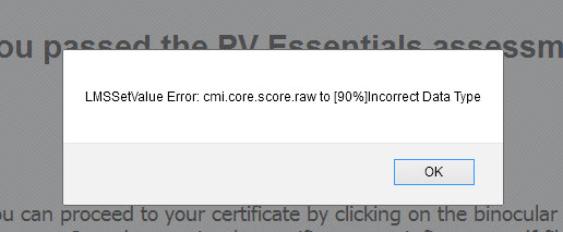

That's because I got the message that refers to the passed/not passed page: "There is a Modify Variable action on this page that modifies the AICC_Score variable. Any modifications to the score may be lost when the student completes a test within this course."
However, I've just tried it...and I still got the same LMSSetValue Error plus the LMS recognized the score as 100.
<3!!!!!!! Yesss!! now it shows no error message...but it still doesn't show the true result only 100%.
