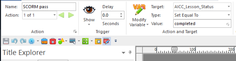

I believe you just need to add an action on a page - for mine I have it execute when the last page shows up. Action Modify Variable
Target: AICC_Lesson_Status
Type: Set Equal To
Value: Completed

We tried that before the system gives a LMSSetValue Error: Data Model Element Type Mismatch when exiting the course. The course shows completed in the report though, but the error message make it confusing for users.
Where did you put the AICC completed action? Is it before or after CMI action?

I did some research... Here's a correction to my post above:
AICC_Lesson_Status is not Scorm 1.2 only.
If you publish to Scorm 1.2, it is used for "cmi.core.lesson_status" (this is Scorm 1.2)
Scorm 2004 has two variables for the status.
When you publish to Scorm 2004, AICC_Lesson_Status is used for "cmi.success_status". This variable can only be "passed" or "failed" (or "unknown"). The error occurs becaue it must not be "completed".
Then there's cmi.completion_status that can be "not attempted", "incomplete" or "completed" (or "unknown"). It must neither be "passed" nor "failed".
Thank you all for the suggestions. I eventually created a dummy test and submit that quiz and set AICC_lesson_Status to completed at its last page. Because it's a page the user never goes, it's never executed together with CMI_completion_status. With that I can publish and get completion status without any error messages. It shows the score to 0, and I will try to set it to 100 before process test.
