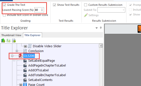

Hi,
I think you are trying to get the score for a test without getting the score submitted to the LMS or AICC_Score.
This can be done by unchecking the check box 'Include test score in overall score" in the test properties. I have included a screen shot.
I do this for all my courses because I don't want AICC_score to be filled until a passing score is achieved.
So when you submit a test, the score gets saved to the variable 'TestName_Score'. In the example on my screen shot that will be 'OL5206_Score'.
You can later have an action somewhere to modify the variable AICC_Score to make it equal to 'TestName_Score' I personally do that by setting that action with the condition that 'TestName_Score' is Passed.
