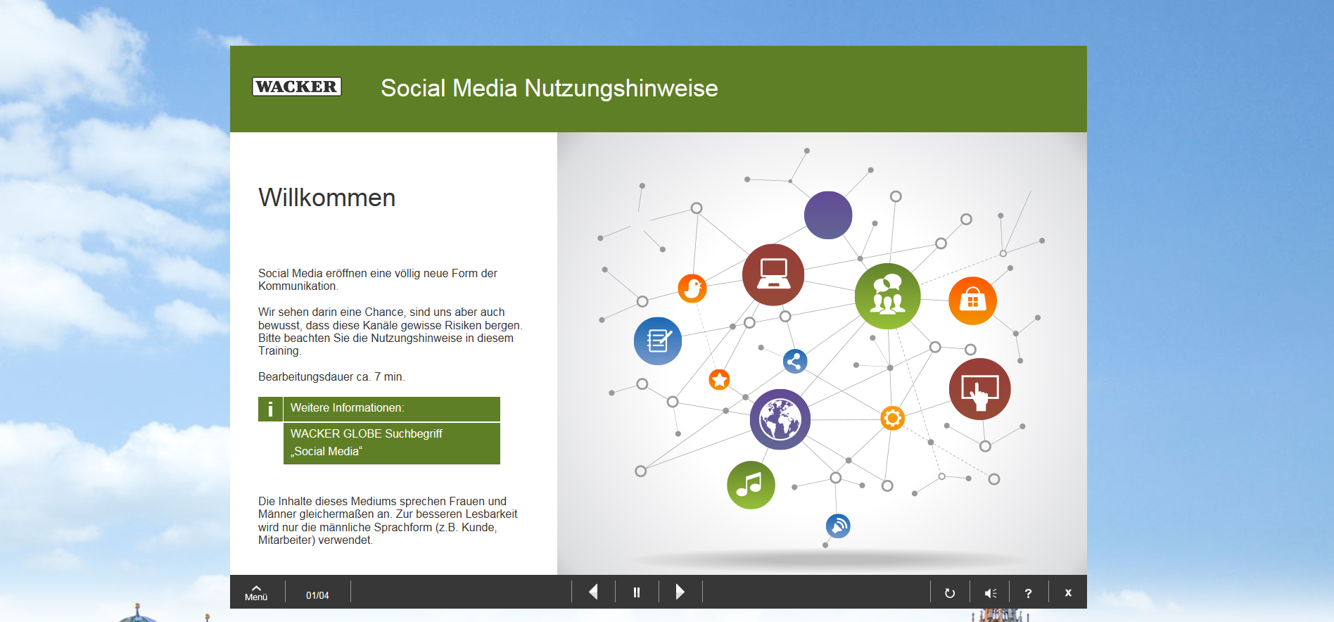

Hi, I would like to locate my course right in the center of the Browser window (like in the example attached).
In Lectory you can choose centre - but the upper course rim is justified at the top of the Browser window. I have learned from Trivantis Support that tehre is no aitomatically function in the tool, but there might be a manual custom JavaScript add on. Can anybody help me with that?

Which version of Lectora is it? The pages are in a div, so it's possible to add margin-top to move the page down in the window, either a static value or by subtracting the course height from the window height to center it vertically.

I'm working with Lectora 17.0.5. Could you please tell me in detail how to add this margin top. My aim is to place the page centered vertically and horizontically - not with a static value, because this should work with different Solutions and devices. Thank you!
Here's a sample. It's all done with the "Run javascript" action on title level.
