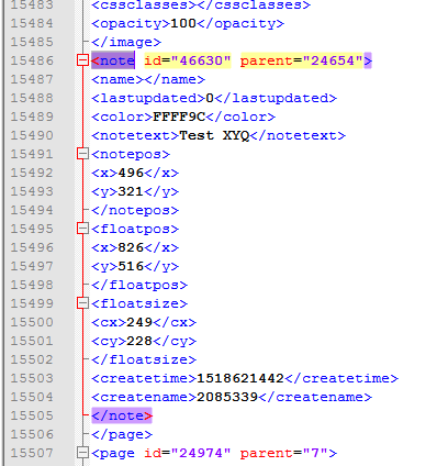

Here's how to delete notes you can't see in Lectora:
  1. Close the file in Lectora.
  2. Open the .awt file in Notepad++. (Any plain text editor, including basic Notepad, will work, but Notepad++ does make it a bit easier, including highlighting the start and end of the node in the next step)
  3. Search for undefined See the attachment.
  4. Repeat steps 3-4 until no more are found.
  5. Save the file.
  6. Re-open in Lectora and see that the notes are gone.

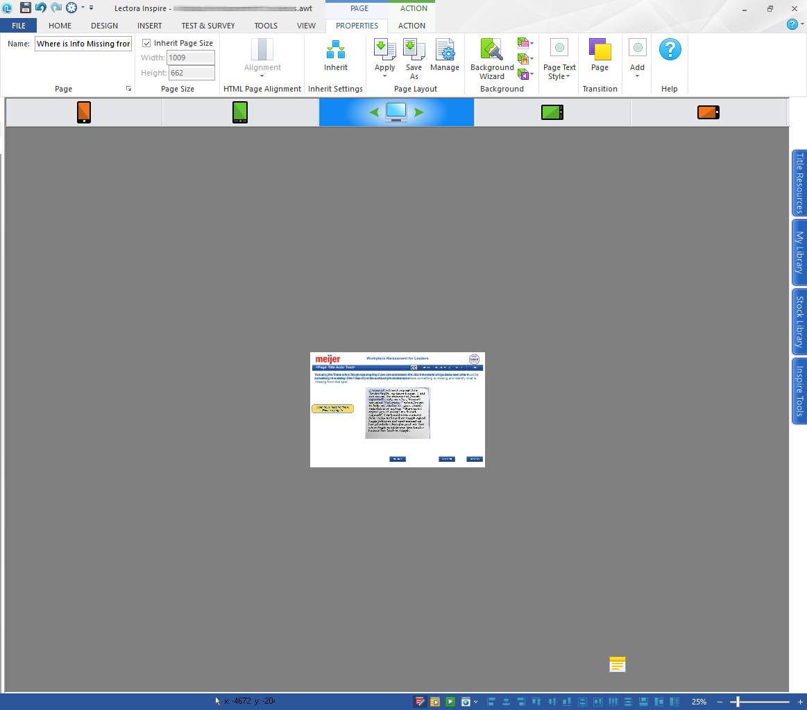

undefinedahetherington9113 The first thing to try is to zoom all the way out, to 25%; sometimes notes jump off the stage, and zooming out shows them. But sometimes not; sometimes they're just nowhere. And like undefinedmsullivan3430, I use notes to remind me of things I still need to do in the course, and I want to get rid of those when I do the things. This is the only way I know of when a note goes missing. (I do not get credit for it; I found the solution in a different thread on this forum a while back.)
And after all there's no point in putting a note in for any reason if you don't want to see it later, and sometimes they just go missing. Similar steps to the ones I posted earlier also allow you to read the text of a missing note, and to reposition it. Referring back to my earlier attachment:
  • The undefined node even lets you change the background color of the opened note (but not of the icon) if you really want to get fancy.

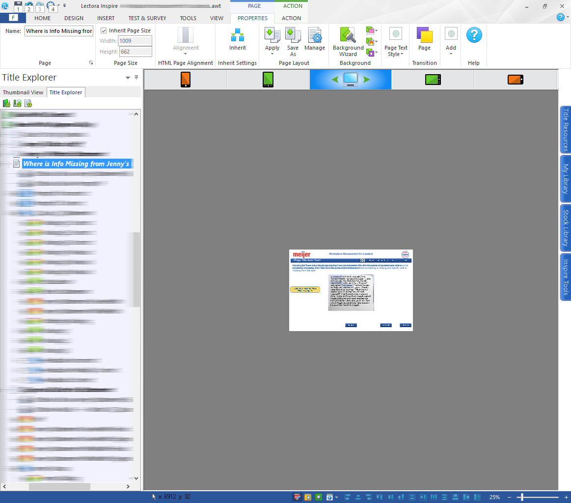

I accidentally discovered a very simple way to reshow (most) hidden notes. It worked on 10 out of 11 notes that had gone missing in my title:
  1. Click on a page with a hidden note.
  2. Drag the divider between the title explorer or thumbnail view and the stage all the way to the left.
  3. You may also need to zoom all the way out to 25%; sometimes I did, sometimes I didn't.
For 10 out of 11 notes, this revealed the note near the lower right corner of the stage, and I could easily drag it back to where I wanted it -- and it stayed there when I dragged the divider back. I had to zoom out for two or three of them, not for the rest.
It's still a silly bug that needs fixing, but at least this workaround is easier than editing the XML directly.
