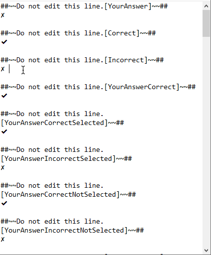

Well I did once 1 course in Dutch/English and added Polish later.
Problem: Publish strings. These strings that say 'Loading course ...', Correct, incorrect, passed, failed etc around a test, you can only use 1 publish string in a course, sadly.
My 'fix' was to create a publish string with unicode signs like the checkmark ✔, cross ✘ etc. to tell the students whether they answered a question wrong and what the correct answer is. (I only show incorrect questions in the test results)
Edit: But for example: the string that tells a student in the test they need to fill in the question before proceeding needs all languages or something else.
