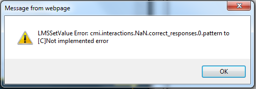

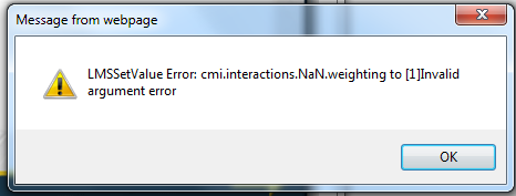

In testing a course in our PeopleSoft ELM system when I click on the last question of the test (which the action is On Click > Submit/Process Test/Survey) I get a series of error messages the first being
LMSSetValue Error: cmi interactions.Nan.id to [Question_1_814_1342470192521] Invalid arguement error
It goes through a series of error message and repeats 1 set per each question of the test.

I'm having the same issue. After each of the 6 tests, my LMS displays various error messages that begin with "LMSSetValue Error: cmi.interactions.NaN.". These tests aren't part of a survey; they're embedded tests inside the course.
Any ideas?

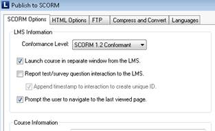

Have you tried un-checking the - Report test/survey question interaction to LMS - box on publish?

I've tried un-checking the Report test/survey during the publish and the issue is still the same. Appreciate if someone can share how resolve this issue. Thanks.
I was having the same issue in Lectora 16. When publishing, I tried unchecking the box labelled "Report test/survey question interaction to the LMS", and it solved the problem :)
Thank you, Kirk! That method resolved the issue :-)
