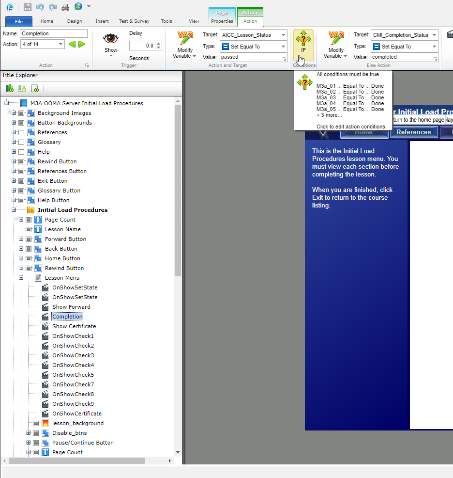

I'm developing a SCORM course in LO that does not have an Exam, and I need some help determining if I have the AICC/CMI completion codes in the correct order and places, or if my manifest file is wrong. I'm not sure how to roll up the course completion of just the lesson AUs.
I have 3 lessons. The user is required to complete each lesson, to complete the course.
In the attached, I'm showing how the action looks now in each lesson. When I scorm test, the lesson scores as completed before I've gone through it to the end, and the course status reports completed, while the Success status reports Unknown.
I tried adding a new variable per AU to capture when a lesson is complete, and actions to the root of the title to capture AICC and CMI. When I scorm test and launch each lesson and then close it without going through it, the lesson scores incomplete, while the course scores Completed/Passed.
So I'm not sure if maybe the manifest is just wrong; I've got 3 items with imsss:sequencing for each, and a final imsss:sequencing.
I apologize if the above sounds confusing this is hard to explain. What am I doing wrong? Is there a sample link someone can send me to gather intelligence?

Hi Christina,
So just to confirm you are publishing to SCORM 2004 correct?
Do you need to use separate AUs for navigation, or can you handle all within one AU?
Let me know and I will try to give you some more guidance... also here is a post I did a while back:
http://community.trivantis.com/forums/topic/using-scorm-1-2-and-scorm-2004-with-an-lms/
If you are using AUs then the completion status Lectora can set is only within the AU itself.
If you need to use multiple AUs then here is a pretty good document that might help with understanding the manifest entries:
See: 6.2.2 Calculate the Success Status
http://www.tdmaryland.org/Resources/Documents/Program%20Documents/FebProgram_ADL/SCORM%20Users%20Guide%20for%20Programmers.pdf
Hi Joe, sorry for the late response. I figured out my AICC and CMI completion actions were not correctly written. I originally had both pass/completion actions appearing within the same action, but ultimately I had to split it up into 2 actions. One to pass lesson AICC; and one to complete CMI. That seemed to get the results were looking for.
