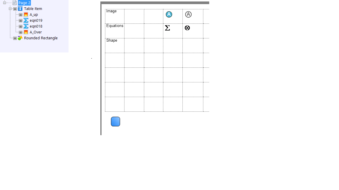

How can I insert a shape in the table? I am able to insert images and equations but there is no options to insert a shape in the cells.
Please find the image attached here. I want to add the shape "Rounded Rectangle" in the table item, as other images and equations are listed under the Table items.
If anyone have any idea about it, Please help.

Not sure it will let you, however you can make the same shape in PowerPoint and save it as a picture then insert it as an image.
or take a screen capture. I'm pretty sure you can only insert images into a table and Lectora saves shapes as .an emf.

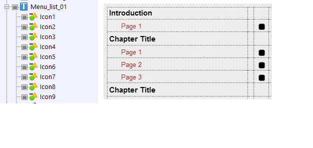

But someone has used the shapes inside the Table. I don't know how?
Please look at these screenshots.

The table was probably brought in from an outside source and they choose to leave the formatting in tact. Right now tables are limited to images, special characters and equations. That's why we recommended you take a picture of what your trying to insert. I did put in a request with our developers to see about adding buttons into tables in a future version of Lectora.
In the published code, shapes are handled the same way as images. I think Trivantis just goofed here. Its a simple fix for them. They already coded the ability to add images, it's no different. The absolute simplest method to add a shape into a table right now would be to publish with the shape you want outside the table. In the published files will be the .png created out of the shape. Just reopen the .awt, insert image and select the published shape .png.

It was possible to insert Shapes into tables in older versions of Lectora. But in newer versions shapes are made differently. What you can do is: Create a shape in Lectora, publish to html, find the PNG Lectora has produced from the form in the published "images" folder. The PNG can be used in a textfield / table. This should work as long as you don't use any of the new effects. The PNG is only the straight form, all shadows, reflections, rotations etc. are not included.
