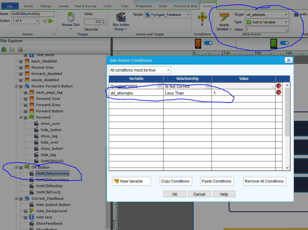

Hi Christina, I had a chance to look at this over the weekend.
All I had to do to get it working was to add a condition and an else action to the first action on the OK button.
See the attached image.
