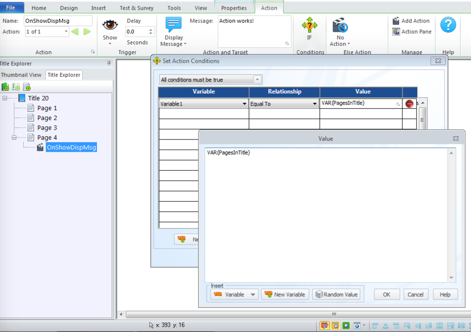

You can simply write "VAR(PagesInTitle)" instead of a value. Or click on the tiniest of arrows in the bottom right corner of that input field to bring up the "Use Variable" dialog. See the attached pic.

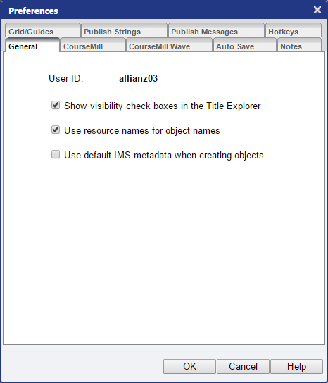

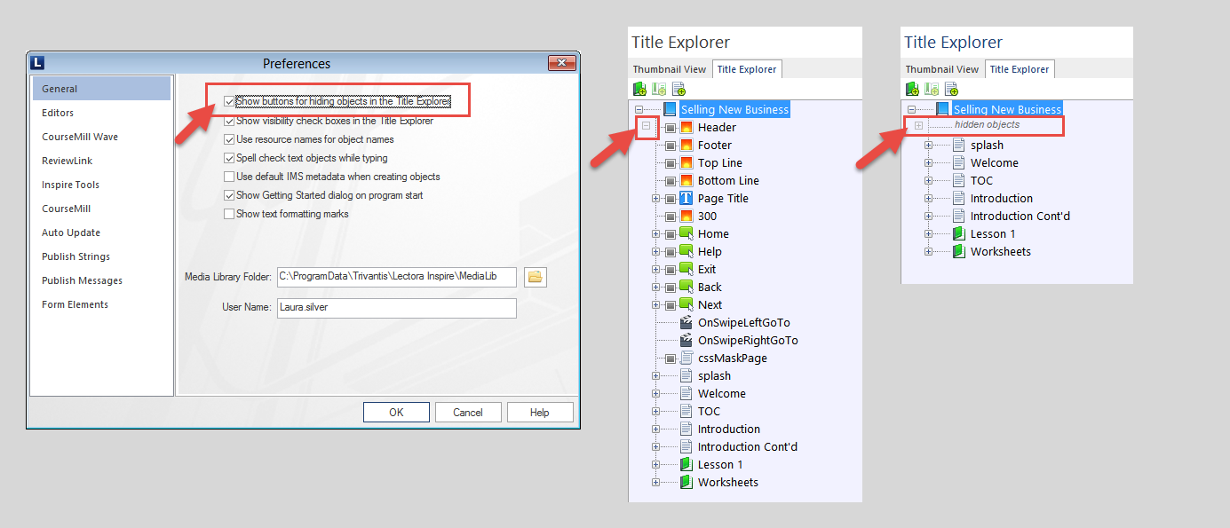

Check out the "Show buttons for hiding objects in the Title Explorer" option in your Preferences.
When you turn this on, you'll see an additional expand/collapse + or - icon in the Title Explorer at the Title, Chapter, and Section level. Selecting this allows you to collapse items at that level to clean up clutter in your Title Explorer.

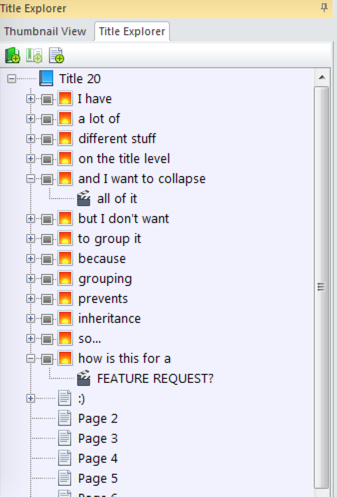

@dfleary, @lsilver, what do you think about making the objects on a title level collapsible? Like if they were in a group, only just visually, to avoid uber-long title explorer scrolls?
