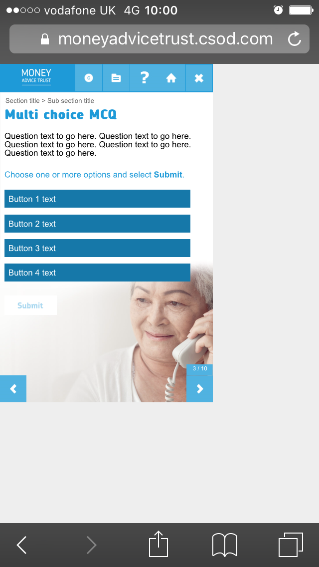

Has anyone build an RCD course to be hosted on CornerStone on Demand? Not using the LMS mobile app feature, the client runs into trouble when running the course on mobile and tablet - the course is shrunk down, to sit top left with a margin right and bottom. I have attached a screenshot of the problem.

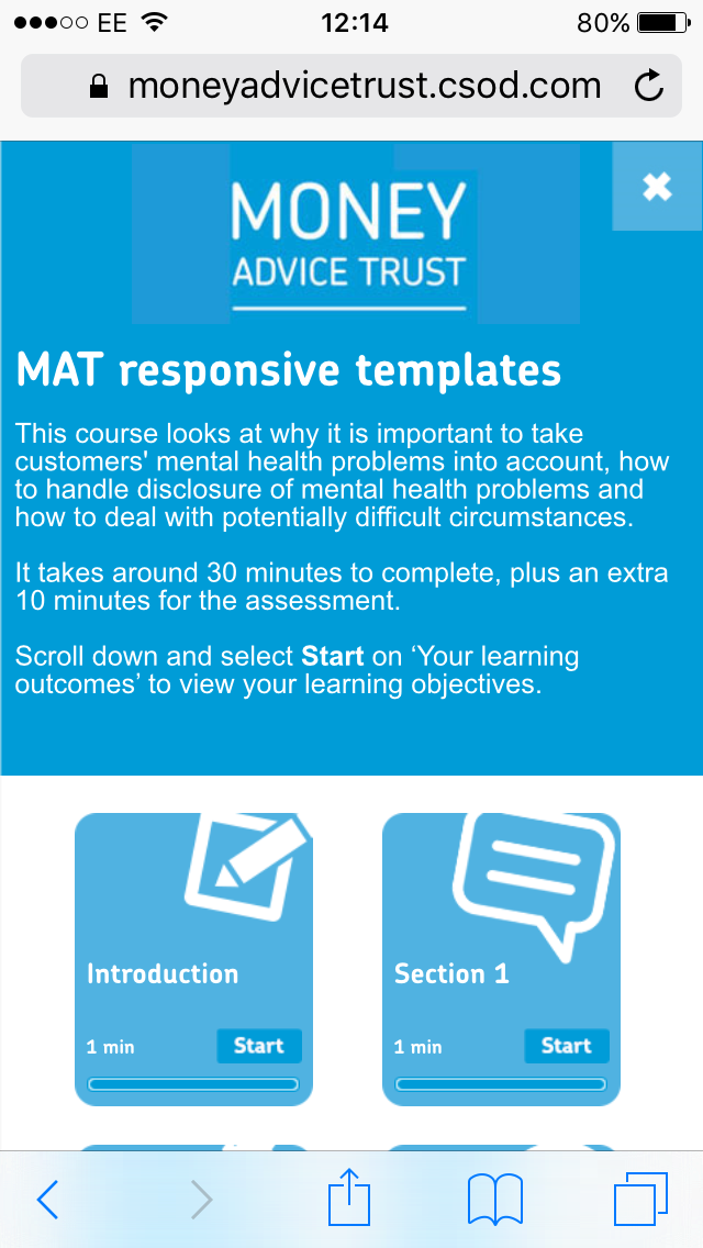

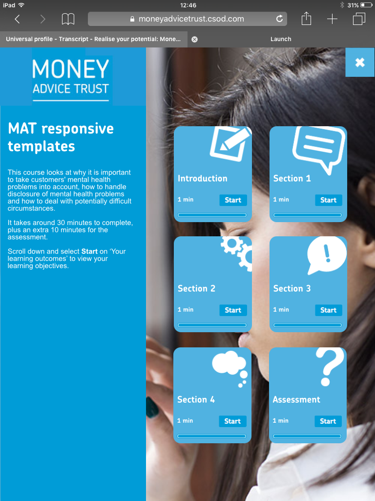

I couldn't get access to the version they provided that screenshot for. That was a Scorm2004 build. I then sent them a 1.2 version, that they could provide me access to, and that works fine (screenshots attached).
So, as long as the client uploaded this correctly for the original version, this looks to be a 2004 issue. I have since been advised by my tech team that "2004 will likely have a different frameset to 1.2, or at least i have seen that on other LMS's".
The client is happy with 1.2 - so for me, problem solved :)
