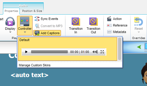

Walter, we're curious as to how you changed the width of your audio controller. The problem seems to be related to that. It's called Default, but is it custom?
Possible workaround, I changed your controller to one of the others and then changed it back to Default. It looks stretched in build view but look OK in Run, Preview Page and Publish, and the CC text is where you want it.
Thanks Therese, that was the problem.
Walter, you can deselect the "Use Web Accessibility", change your controller then change it back to Default, then reselect "Use Web Accessibility"
We're looking into what may have caused the controllers to be so wide and effect the CC, but we don't have an answer yet
@Walter, if you have checked the Use Web Accessibility Settings under Title Options tab, you will not have access to different skins. The drop down menu will only show the default and accessible skin. Other skins are not accessible. To see other skins, you need to deselect the Use Web..., however, that will yield accessibility compliance errors when you test it. I don't know how far your organization will be flexible about this.
Select the audio and go to Properties. You'll see Controller on the ribbon. Select that and you'll get a dropdown of the different controllers.
I'll try to look into how the controller width may have changed, that's a little confusing.
Hey Walter, actually the smaller controller is the correct size and will probably show your closed caption text correctly. I'm not sure what's going on with the title, but there should be several controllers for you to pick from.
I'll open a bug to have dev look into this.
I'll attach a custom skin I used for testing, please let me know if this helps. Steps:
  1. select the audio as you did before, and select Manage Custom Skins
  2. In the dialog select Import skin and load in the custom skin I am attaching
  3. you can then change the controller to this skin, then change it back to default
