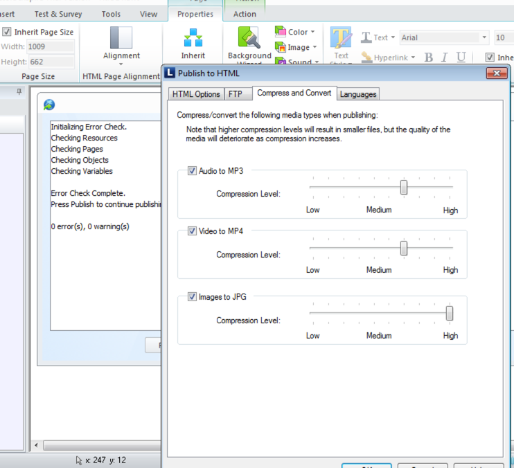

Check if compression is enabled in the Publish settings (see pic). Adjust the slider or better yet uncheck the box to make sure Lectora doesn't compress your videos.
