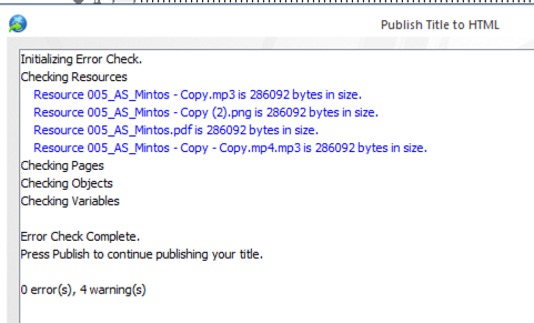

Audio files and MP3's - Does anyone have a file size recommendation for the audio files inserted into Lectora? I have searched but don't see any recommended sizes for the mp3's.
I currently have a course where I have multiple audio files and when published get a warning for each of my audio files (example: Resource 2ENG.mpe is 314672 bytes in size.
Does anyone have a recommended file size for audio files?

The warning is set to appear at 128Kb.

Bitrate of 96-128 Kbit/sec is more than enough for any audio in e-learning. If the learner's bandwidth is more than 128Kbit, they will have no delays in streaming these files. And even the worst cellphone connections have that covered now.
Here's a useful table (click here) that explains how bitrate translates into megabytes per minute and per hour. Keep in mind that anything below 64Kbit/s is hard to listen to and anything above 128 Kbit/s is an overkill for e-learning (unless you do a course on sound production for professional musicians of course :))
I find Lectora's warnings overly pessimistic (300 Kbytes for an mp3 isn't much!), so I tend to ignore them most of the time.
