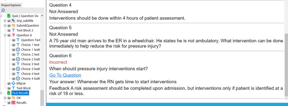

I created a multiple choice test question that has individual feedback for each answer. There are four choices. When I display the feedback immediately the feedback works correctly, i.e., in the pop up. But the feedback on the test results page only shows the first two options, i.e., correct and incorrect respectively and won't display the feedback for choices 3 and 4. My client wants to only display feedback on the test results page and it works okay if it is simply a correct/incorrect option, but not with the individual choice feedback with more than two answers. Is this an issue that anyone else has run into? I've tested it in another module and a coworker also tested with the same results. I'm using Lectora desktop version 21.3.

I was testing this out - and it appears that the only results that will show using the results designer is the message feedback for whatever option #2 is. It doesn't seem to matter what you select, Option 2 response (when using the Display Message action) is going to be the only thing that shows up in the Test results from the test Results page...
Here are the settings I have. Thanks for the example. My issue isn't on the quiz page itself, but on the Quiz results page after the test is complete. See the image (quizresultspage_feedback). My question 6 in the screenshot has individual feedback for each option as shown in image 1 (quizfeedbacksettings), but on the results page the feedback only shows for the first two answers regardless of the choice selected (i.e., 3 or 4 are the same as option 2 - see image quizResultsPage_FeedbackOpt3Sel).
For what it is worth (maybe for the Dev team), this functionality appears to work appropriately in Lectora Online - so probably a bug in the desktop version.
