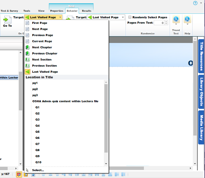

Is it possibly because the test level behaviors are overriding the page level behaviors? Try going to the behavior tab, selecting no action from the on completed and the same for on failed.
Thank you for your time and the idea! When I navigate to assign action upon completion I do not see that as an option.
Additionally, this file worked as expected until the last Lectora update. It is only once I published file for the first time after update that this became an issue.
The system by default will send you to the next page (in Lectora Publisher or Inspire) or to one of the pages created (in Lectora Online). This is so you can specify where you want the learner to go after the test is completed/passed or canceled/failed. If you'd like the navigation to happen otherwise you can either send both options to a landing page where they can branch off or see content controlled by variables. Another option is to create a blank page that loads but have a redirect on it to happen right away.

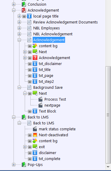

I have the same issue:
When I publish and step through the program, the page (before last) that processes the test auto-advances. The last page, which marks the status as complete also auto-advances but the course still gets marked "completed" in the LMS (GeoLearning/Maestro/SumTotal Growth Edition). See page structure in attachment.
So basically, after completing the single question test, the last two pages of the module auto-advance.

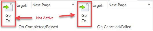

In checking the behavior properties of the test, I'm unable to change the action - only the target - as the action button is not clickable and statically set to "Go To" (see attachment).

Hmm. I copy the module year-after-year and don't remember changing any of the logic but this year, the behavior seems to work differently from previous years (using Publisher and then Inspire).
The good thing is, I was successful at getting it to work to my expectations by changing both the Completed and Canceled destinations on the Behavior tab to "Current Page." Now the page no longer auto-advances.
All is good in the world. :-)
