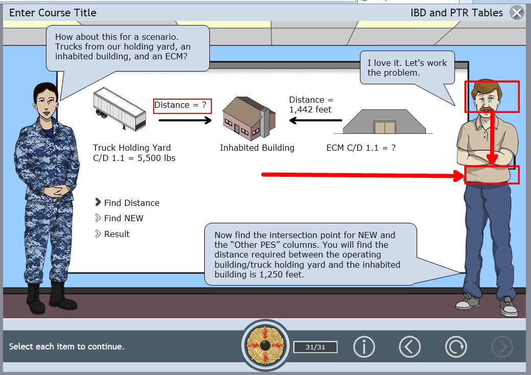

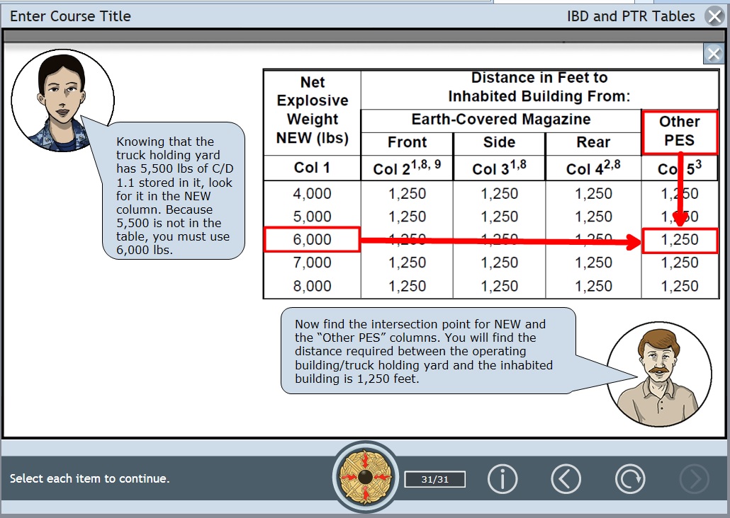

Hi all. I'm in serious need of some help please. I'm currently building a 3 item click to reveal text in version 16.2.2. Reveal 1 has a table and as my first head talks about something, a rectangle appears on a delay, then the next head's speech bubble, then another rectangle, then finally 2 arrows and a third rectangle. I had it timed and set up to run very nicely, but here's my problem. If my learner exits out of my Reveal_1 before all the transitions have run, then they STILL run, but on the "home" page (not the reveal page) and it makes no sense because you've got boxes and arrows appearing over an image. I've tried not using transitions and using actions with a delay. I've tried placing those actions on the objects themselves, as well as placing the actions on the background image in the Reveal_1 screen. I've tried putting the actions in the click too. I've tried on mouse click, I've tried on show, and I've tried on page show. Nothing seems to be working for me. I love how transitions let me regulate the flow of information on a screen, but this is a headache. Who can help me out?
