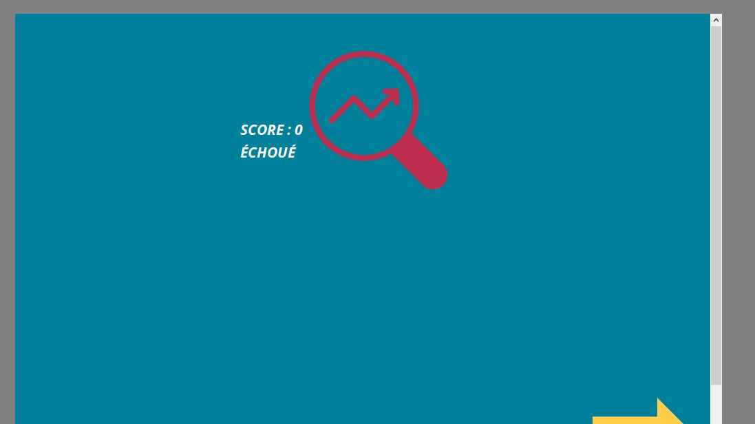

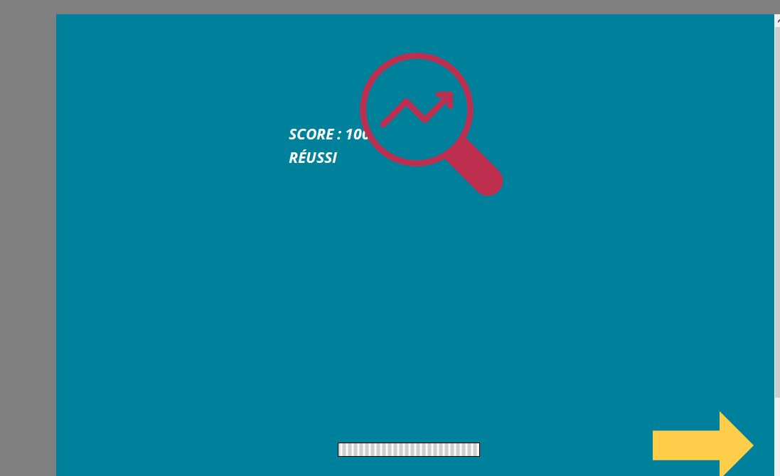

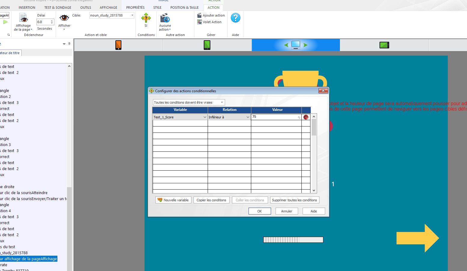

I get a question about test settings. I created 3 Lectora tests. When i get my score, I get my test score and if it I failed or passed. I would add an object to my score. If I get 75% or more, I would like to add a picture. If I get less than 75%, I would like to add an other picture. My tests are set as 75% lower score to pass.
But when I try my test, it's always my failed picture which appears. Even if my score is 100% or 75%. Could you tell me how it's working ? Thanks !
I can't find a problem, the settings should be correct. Only the trigger "Affichage de la page" may come to early. You might try to move the action from the image to page level and trigger it "On: Show" ("Afficher").
By the way: For a test score you can also use conditions like: "If Test_1_Score Is Not Passed" (or Is Passed) which liberates you from changing the value in case you change the pass rate for the test.
