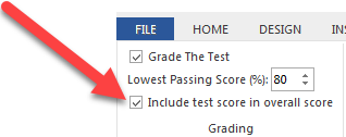

HO HA! Yes! I found it!
In test Behaviors, there is a checkbox called "Include test score in overall score." It was deselected. Normally, this is selected. See screenshot below.
I had previously turned this checkbox off in TEST settings (almost never mess with it) because this course USED TO have 2 separate tests (depending on which type of store you were in).
We recently made it uniform across all stores so I removed the “other test” within the course. But I never re-selected this checkbox on account of I just didn’t remember to turn it back on.
