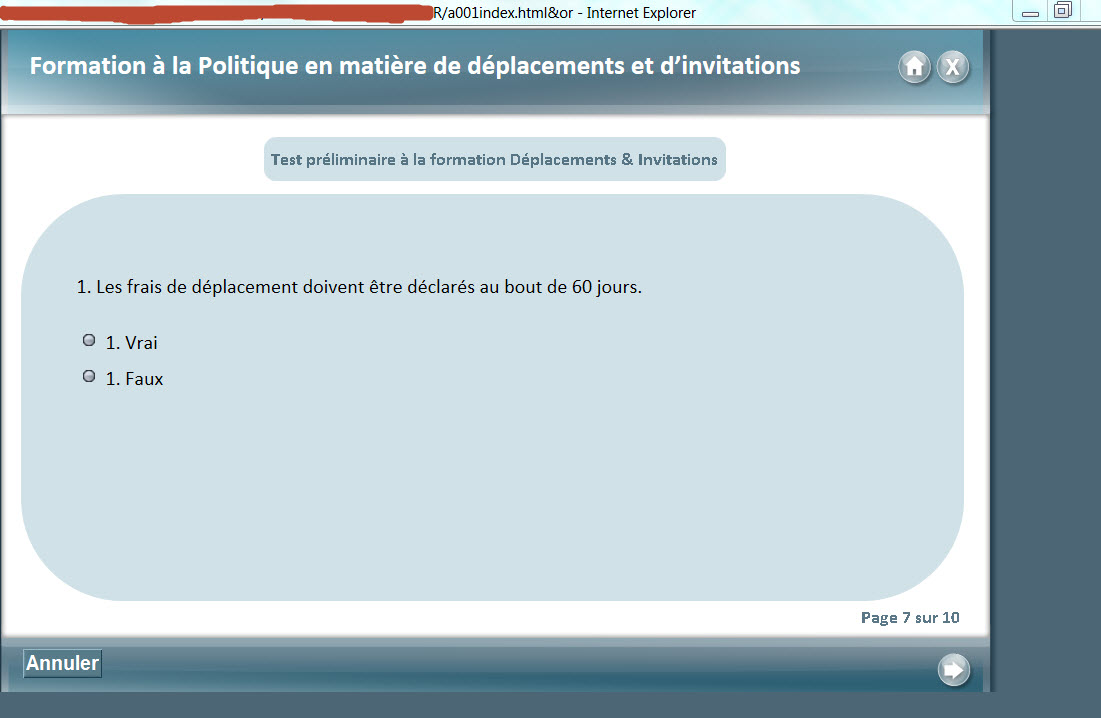

Second, one other question in the test shows additional text after published that is not there in the application. In development there is the question, with true/false radio buttons for the user to select their answer. Once published to my LMS the question, and both answers have "1." in front of their text. This doesn't show in "Run" or "Preview" but will show in the "Preview Page in Browser" mode. I've attached a screenshot of this issue.

Answer 2: I've seen this issue before with non English content. There seems to be special characters in your answer text box that are manifesting in html as a 1 (we use to call them the phantom 1's because they don't show up until you publish). You'll need to most likely recreate the question and paste the answer unformatted (control+shift+ paste). If that doesn't work I suggest recreating the question and manually typing the answers in. Then you can add formatting later.
Hi Jennifer,
Thanks for this suggestions for issue 2. I ended up recreating both questions that were giving me issues. I've republished them and both are working in the LMS now.
